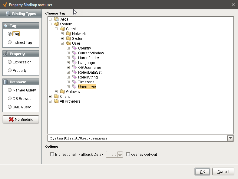

I want to be able to grab the username of the logged in person and display it on as a text label
**Post date:** [September 12, 2017, 3:43pm UTC](https://forum.inductiveautomation.com/t/system-security-username/15316/2 "2017-09-12T15:43:19Z")
You don’t even need the scripting function. There’s a client system tag that has the logged in user’s name, just bind that to your label text value.
**Author:** ![ryanjmclaughlin](https://sea1.discourse-cdn.com/inductiveautomation/user_avatar/forum.inductiveautomation.com/ryanjmclaughlin/32/4318_2.png) [@ryanjmclaughlin](https://forum.inductiveautomation.com/u/ryanjmclaughlin)\
**Post date:** [September 12, 2017, 3:44pm UTC](https://forum.inductiveautomation.com/t/system-security-username/15316/3 "2017-09-12T15:44:18Z")
@Kevin.Herron beat me to it!
 ![](https://us1.discourse-cdn.com/inductiveautomation/original/2X/d/d3084bae9bcc5c013c41391a3eb1eb8252aa4b3b.png)
