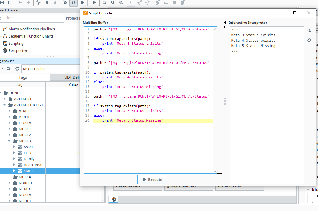

If I run the following in the script console
gnamePath = '[MQTT Engine]DCNET/MAP/S1/R1/B1/G10/Name'
if system.tag.exists (gnamePath):
	print 'Tag Exists'
and a folder for [MQTT Engine]DCNET/MAP/S1/R1/B1/G10/ is present , BUT the tag “Name” is NOT present in that folder then this will print " Tag Exists"
The function description is
Checks whether or not a Tag with a given path exists.
The folder has no tags in it is this the problem?

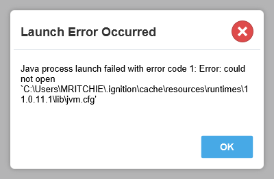

Updated to 8.1.12 now getting this message
![image](https://us1.discourse-cdn.com/inductiveautomation/original/3X/d/e/de396ef6048590f2f3add8f0fcd06dce110cb871.png)
only file in this path is modules file. Tried uninstalling, and downloading designer for reinstall. No luck
**Post date:** [November 19, 2021, 6:01pm UTC](https://forum.inductiveautomation.com/t/system-tag-exists-but-it-doesnt/53271/5 "2021-11-19T18:01:50Z")
Delete the `11.0.11.1` folder in that path and you should be able to launch.

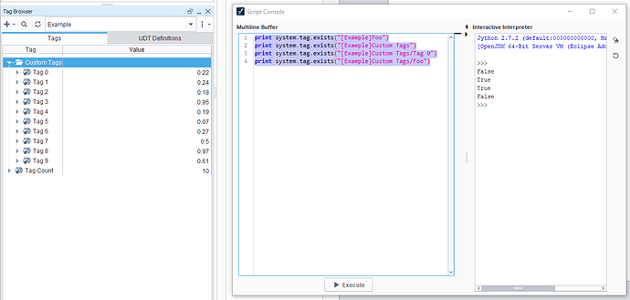

**Post date:** [November 19, 2021, 7:11pm UTC](https://forum.inductiveautomation.com/t/system-tag-exists-but-it-doesnt/53271/9 "2021-11-19T19:11:59Z")
I think this might be a bug that is specific to the MQTT modules.
I thought maybe it affected any ManagedTagProvider implementation but I just tested against the provider from the SDK example and it works as expected.
I’d contact Cirrus Link or maybe paging @wes0johnson will work 🙂

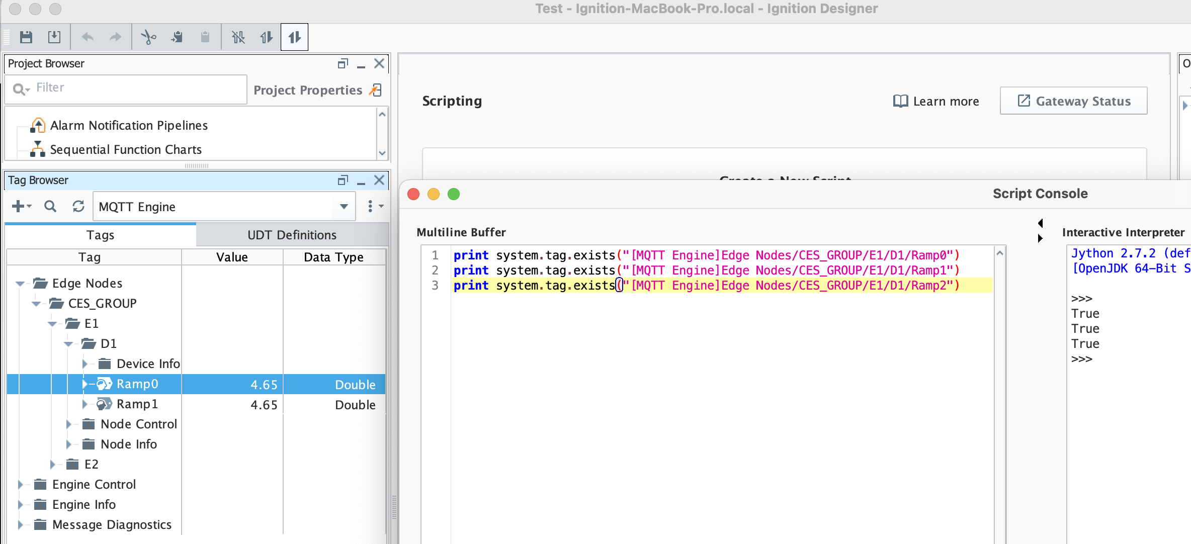

So I think I figured this out. I was not able to reproduce with the SDK example, but I was with Engine. This is how I got it to happen:
1. I created an Edge Node with 3 tags under a single device and published from Transmission
2. I deleted one of the tags from the Edge side
3. I restarted MQTT Engine (this is key)
4. I published a new birth from the Edge
This produced the following:
 ![image](https://us1.discourse-cdn.com/inductiveautomation/original/3X/1/3/13068f0f8a27ccbde0bf9f56bc68f3d59fd93786.png)
The reason is that MQTT Engine does not persist tags. But, it does still persist the tag configuration. So, I think ‘tagExists’ looks to see if it is in the DB tag table - which does not necessarily mean it is visible in Designer. With this, I suspect the tag you are trying to look up did exist at one point and was never deleted from the Ignition Tag DB (via a delete event or similar). But, Engine has since been restarted which is why it is not visible in Designer.
I believe that if you delete that tag from the DB, tagExists will properly return false.
