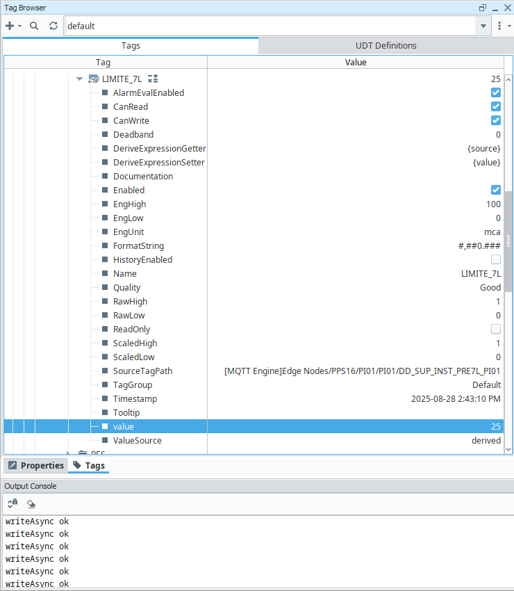

**Author:** ![diego.marques](https://sea1.discourse-cdn.com/inductiveautomation/user_avatar/forum.inductiveautomation.com/diego.marques/32/79285_2.png) [@diego.marques](https://forum.inductiveautomation.com/u/diego.marques)\
**Post date:** [August 28, 2025, 5:57pm UTC](https://forum.inductiveautomation.com/t/system-tag-write-not-writing-all-tags/110243/6 "2025-08-28T17:57:52Z")
@pturmel
I received a positive feedback from callBack, but most of my values ​​were not sent to the PLC.
> **Script console**
> ![script_console](https://us1.discourse-cdn.com/inductiveautomation/original/3X/4/c/4c55619f741920b150bcbb0f1bd0407938214288.png)
> **Output console**
> ![output_console](https://us1.discourse-cdn.com/inductiveautomation/original/3X/8/7/8776f11621a4be4e77cd437903617a69de990b2c.png)
If I click countless times `Execute` in Script console, eventually some values are sent, but not all of them. Same with my button at runtime.
**Post date:** [August 28, 2025, 7:00pm UTC](https://forum.inductiveautomation.com/t/system-tag-write-not-writing-all-tags/110243/7 "2025-08-28T19:00:15Z")
> [@diego.marques](#):
`system.tag.write` is **not** writing directly to the device. It is writing to the Ignition Tag. Depending on the type of tag that is, how it is configured, and how the device is configured, values may take longer than you’re expecting to be written to the PLC. Note that it is also possible that the device itself is over writing your values and so they are being sent but the PLC is wiping them out.
