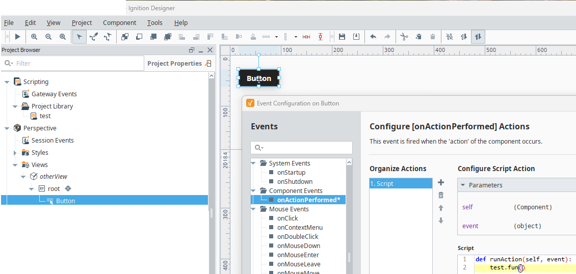

In the Perpective Module
In a view, a button call the same script
test.fun()
 ![image](https://us1.discourse-cdn.com/inductiveautomation/original/3X/8/a/8a48be89dd4e4543ac30cc38e43324482ed23996.png)

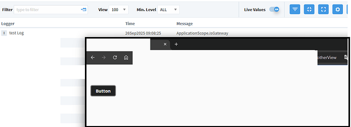

In the Gateway Logs
ApplicationScope appear to be “isGateway”
 ![image](https://us1.discourse-cdn.com/inductiveautomation/original/3X/6/d/6da696b8a57fd58fc64e9c18b5758c8a53a16a1a.png)

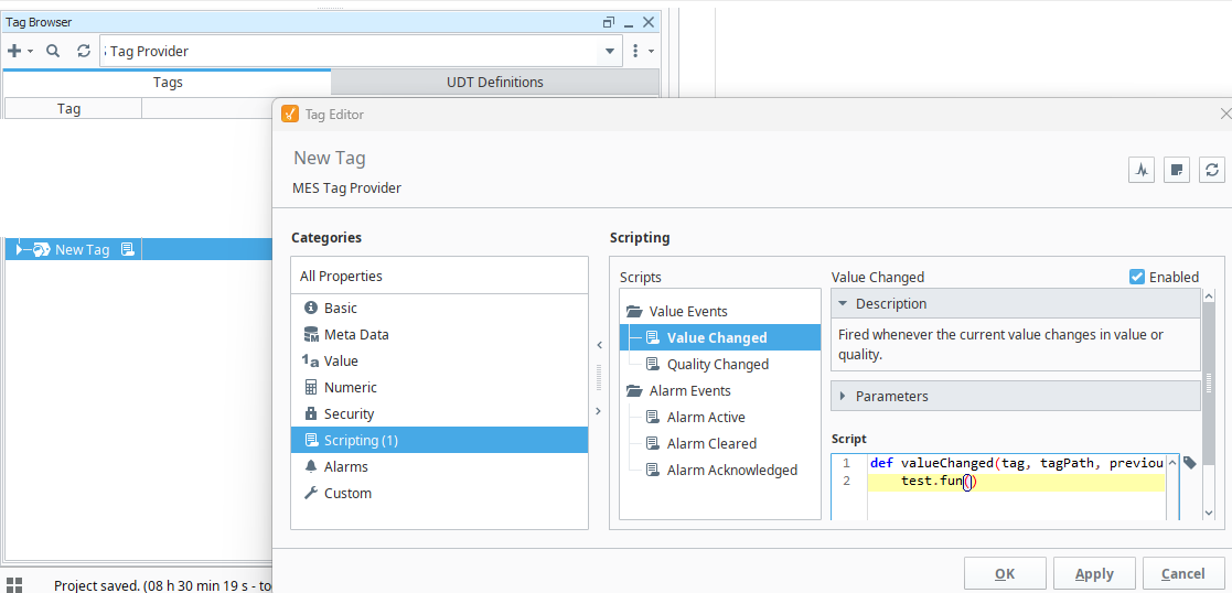

In the Tag
A tag is defined and have a Value Changed Script that call test.fun()
 ![image](https://us1.discourse-cdn.com/inductiveautomation/original/3X/b/1/b1a76414f05aba68df3913c36374b890fc141e38.png)
In the Gateway Logs.
 ![image](https://us1.discourse-cdn.com/inductiveautomation/original/3X/f/f/ff1c64acd60d555c7988d3bb8ae1e1d9ce4167e9.png)

**Post date:** [September 26, 2025, 1:49pm UTC](https://forum.inductiveautomation.com/t/system-util-getsystemflags/48903/9 "2025-09-26T13:49:12Z")
> [@olivier.cote](#):
> In the Gateway
> A script calle test.fun() is defined
This is a common misunderstanding. Functions defined in a Project Library, have no scope. They are run in the scope from which they are called.
A function defined in a project library, which is called from a vision component, will run in Vision Client Scope. That same function called from a perspective script transform will run in Gateway (Prespective) Scope. That same function called from a Gateway Event Script will run in Gateway Scope.
If that function is defined in the Gateway Scripting Project and is called from a Tag it will run in Gateway Scope.
As you can see, there are really only two scopes, Gateway and Vision Client.
Prespective is a varient of Gateway Scope, and Designer Scope is a varient of Vision Client Scope.
