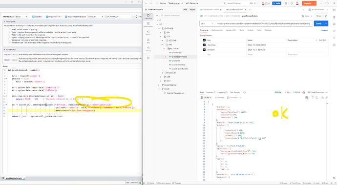

After upgrading to ignition 8.3, something broke with the system.util.jsonEncode function.
If the call is made from the webdev module, some key-value pair will changes to dictionaries?
**system.util.jsonEncode called from WebDev:**
 ![jsonEncode-webDev](https://us1.discourse-cdn.com/inductiveautomation/original/3X/0/a/0a929bea527083b4358e297b373c3144c304149a.png)
**system.util.jsonEncode called from project script or message handler:**
Webdev in 8.1 would generate the same output. _(the desired output)_
 ![jsonEncode-ProjectScript](https://us1.discourse-cdn.com/inductiveautomation/original/3X/e/8/e8451c1c738b41b35cc88c913e113d5f6baf3ac2.png)
Am I missing something?
Thanks

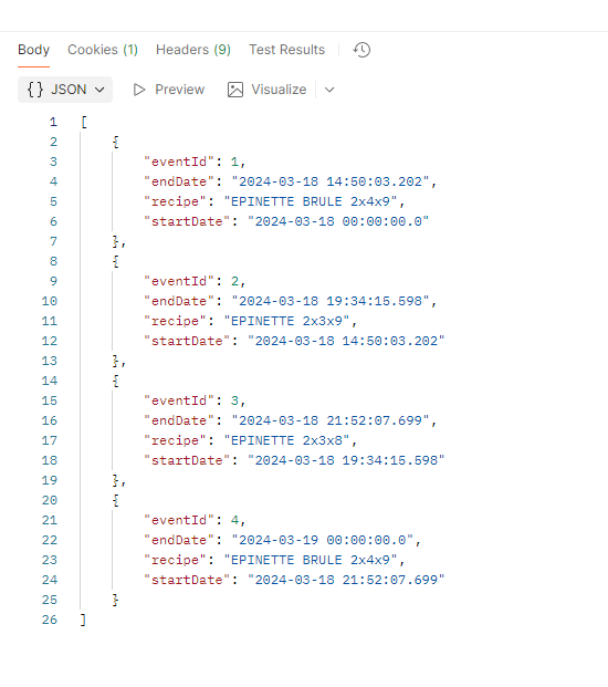

the sendRequest sends back a list
**Author:** ![Jean-Maurice\_Dubois](https://sea1.discourse-cdn.com/inductiveautomation/user_avatar/forum.inductiveautomation.com/jean-maurice_dubois/32/80996_2.png) [@Jean-Maurice\_Dubois](https://forum.inductiveautomation.com/u/Jean-Maurice_Dubois)\
**Post date:** [September 23, 2025, 12:45pm UTC](https://forum.inductiveautomation.com/t/system-util-jsonencode-output-not-the-same-in-webdev-module/110887/6 "2025-09-23T12:45:52Z")
this is the message handler:
the commented line, that what it was before I change to 8.3 to get my result.
now if I encode here, no problem.
 ![image](https://us1.discourse-cdn.com/inductiveautomation/original/3X/c/f/cf5dc8ab81e2ff03ab3e2e5bdd0383c864c1d91f.png)
modified webdev part, this gives me what 8.1 did.
 ![image](https://us1.discourse-cdn.com/inductiveautomation/original/3X/b/f/bfffa1b2493be3f865a7435390b3ce981b7f72cb.png)

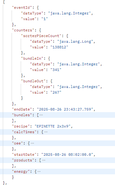

**Post date:** [September 23, 2025, 12:53pm UTC](https://forum.inductiveautomation.com/t/system-util-jsonencode-output-not-the-same-in-webdev-module/110887/7 "2025-09-23T12:53:34Z")
What kinds of things are in the `res` list?
It seems that whatever they are, they might not be getting serialized/deserialized when returned by `sendRequest` the same was as in 8.1, or may be entirely different now.
**Post date:** [September 23, 2025, 1:15pm UTC](https://forum.inductiveautomation.com/t/system-util-jsonencode-output-not-the-same-in-webdev-module/110887/9 "2025-09-23T13:15:21Z")
replicated in simple projects
[test\_remoteGtw.zip](https://forum.inductiveautomation.com/uploads/short-url/weQsFkTxkgpPAEwU0q1xTOogTH2.zip) (3.1 KB)
[test\_caller.zip](https://forum.inductiveautomation.com/uploads/short-url/3PAB7pNhDEcWx9m9W2GmbVSFiAT.zip) (4.7 KB)
 ![image](https://us1.discourse-cdn.com/inductiveautomation/original/3X/5/c/5c55730b887bcf5abdbe906a2baea66d03322db1.png)
**Post date:** [September 23, 2025, 1:23pm UTC](https://forum.inductiveautomation.com/t/system-util-jsonencode-output-not-the-same-in-webdev-module/110887/10 "2025-09-23T13:23:12Z")
@paul-griffith do you recognize that dataType/value pair? Is this maybe some protobuf RPC thing?
**Post date:** [September 23, 2025, 1:56pm UTC](https://forum.inductiveautomation.com/t/system-util-jsonencode-output-not-the-same-in-webdev-module/110887/11 "2025-09-23T13:56:26Z")
remark: I did change from java serialization to protobuf in gateway settings.

**Author:** ![mgross](https://sea1.discourse-cdn.com/inductiveautomation/user_avatar/forum.inductiveautomation.com/mgross/32/3311_2.png) [@mgross](https://forum.inductiveautomation.com/u/mgross)\
**Post date:** [September 23, 2025, 6:22pm UTC](https://forum.inductiveautomation.com/t/system-util-jsonencode-output-not-the-same-in-webdev-module/110887/14 "2025-09-23T18:22:29Z")
Ok we figured it out. It’s because the values are in a list, which is triggering a bug in one of the deserializers. I put in a ticket to get this fixed ASAP. Thanks for the simplified examples, they made this much easier to replicate.

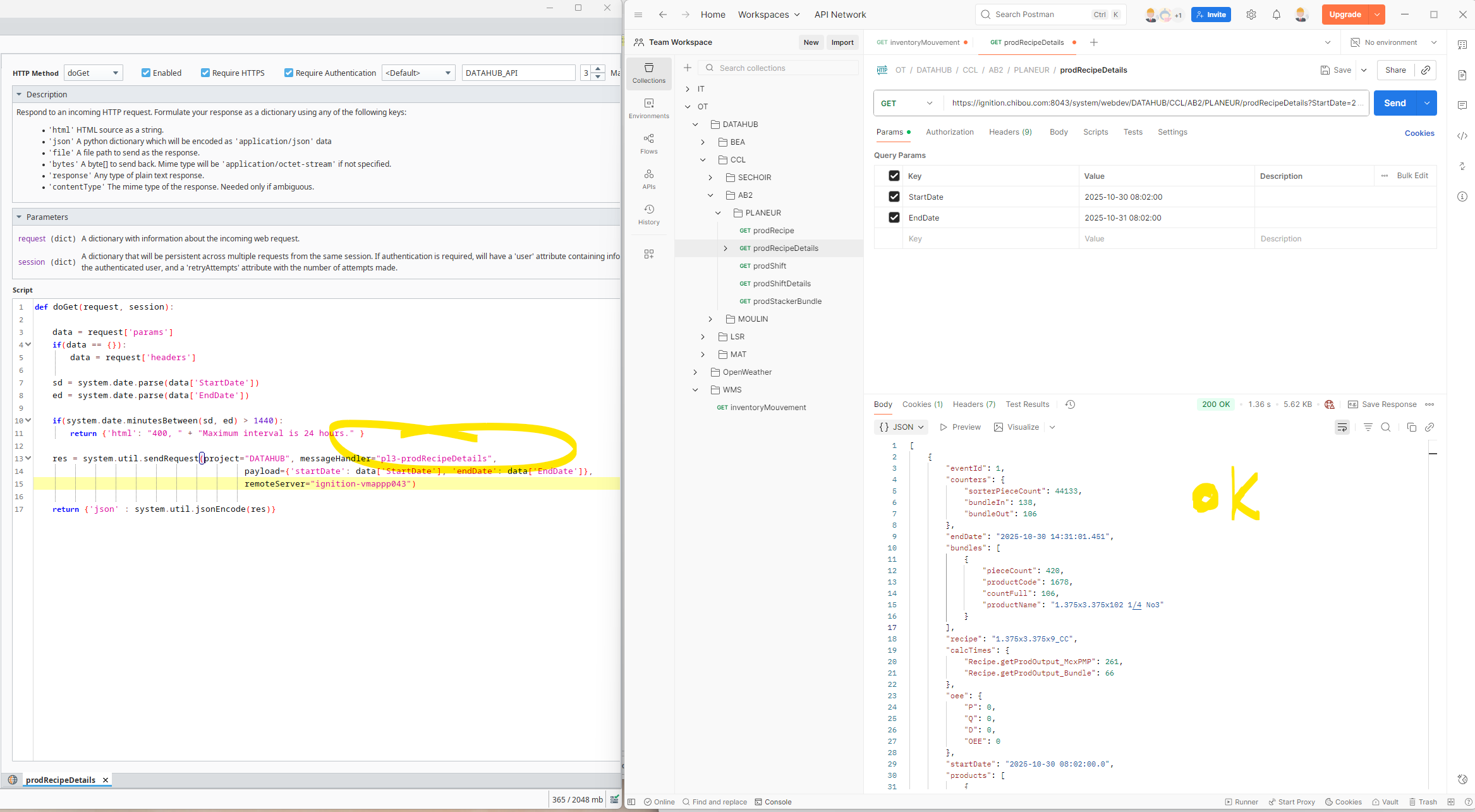

**Post date:** [October 31, 2025, 1:09pm UTC](https://forum.inductiveautomation.com/t/system-util-jsonencode-output-not-the-same-in-webdev-module/110887/15 "2025-10-31T13:09:23Z")
Hi,
Version 8.3.1 fixed all the above but there is still something happening in the script console.
For example:
Webdev module, call a fonction on another gateway. Works fine, I get a result.
 ![image](https://us1.discourse-cdn.com/inductiveautomation/original/3X/d/3/d3614431644b4afb2c9f7f36a3d5fc6d1514b25b.png)

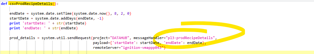

I have a script that call the same fonction, same parameters (for my example):
At the end, this sends a email
 ![image](https://us1.discourse-cdn.com/inductiveautomation/original/3X/7/2/72494abc784ed53aa76229fb36409cd1ecad633b.png)
this gets call by a Scheduled script:
 ![image](https://us1.discourse-cdn.com/inductiveautomation/original/3X/0/9/09a0cddbf632b23246029565eb14be3829828443.png)
I do get my email, all si fine.
 ![image](https://us1.discourse-cdn.com/inductiveautomation/original/3X/f/6/f687fa82f1ccbef2e4e4f4189db0a2a67e00b280.png)
but if I call the same fonction in a script console (for debug purpose for example) and :
 ![image](https://us1.discourse-cdn.com/inductiveautomation/original/3X/3/a/3a2ef9ed2541f41fed900aec7a2372ab749b1adc.png)

Sure.
Message handler:
![image](https://us1.discourse-cdn.com/inductiveautomation/optimized/3X/9/c/9c9459b1808396f31f4f03788fc50a645d9d4bfb_2_690x61.png)
Function:

I do not know why in the stack trace shows the number has a float.
It should be an int.
We are breaking at this position in the response.
 ![image](https://us1.discourse-cdn.com/inductiveautomation/original/3X/4/7/47d8924795b856a432bd6211f74e716a6a1f0489.png)

Here is an example of the output of this function:
 ![image](https://us1.discourse-cdn.com/inductiveautomation/original/3X/3/a/3abe5738ce99636acc681f89e854146fc438faff.png)
So basically, I get the list of the recipe ran that day. Add some data to each “eventId”.
When done, add result to output list.
After all compiled, return results (output)
