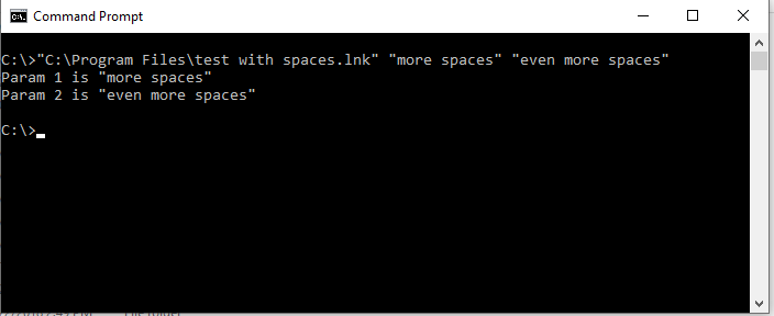

**Post date:** [April 7, 2022, 3:00pm UTC](https://forum.inductiveautomation.com/t/system-util-perspective-typeerror-expected-1-args-got-2/58161/9 "2022-04-07T15:00:58Z")
> [@victordcq](#):
> test.lnk "lnk params with spaces" "does this work?"
Yes.
 ![image](https://us1.discourse-cdn.com/inductiveautomation/original/3X/5/7/573fc6a5de4f5b84e21dac61fd5c202dea55c368.png)

**Post date:** [April 7, 2022, 3:08pm UTC](https://forum.inductiveautomation.com/t/system-util-perspective-typeerror-expected-1-args-got-2/58161/11 "2022-04-07T15:08:05Z")
Don’t know what to tell you.
 ![image](https://us1.discourse-cdn.com/inductiveautomation/original/3X/f/5/f5d35ca1cfae32cc8846b28f913b29a1485151ec.png)
