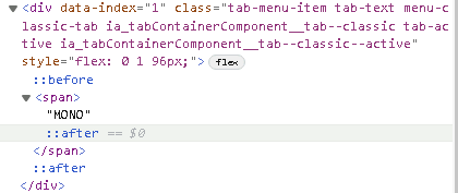

I removed all my classes and it’s still there, although not visible becuase it is the same color as the inactive tabs. Looking in developer options I see:
 ![image](https://us1.discourse-cdn.com/inductiveautomation/original/3X/2/a/2a74bb4488cde7486245bb3355284b22d7d803b8.png)
I checked another tab container on another view and its there as well, I just never noticed it because it was the same color as the inactive tab

Here is my tab in the Elements inspector
 ![image](https://us1.discourse-cdn.com/inductiveautomation/original/3X/6/1/6158c63fdc3eb2066371d5619101203581c8063f.png)
Maybe some of those classes are set in my stylesheet, I’ll dig deeper
