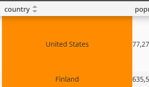

I've tried every combination I can think of for the table row and cell properties, but can't seem to get a view to expand to fill the auto height of a row:
 ![image](https://us1.discourse-cdn.com/inductiveautomation/original/3X/4/1/41f964d927a4db4088724335ce04fb3d1216f43b.png)
I even added the `position` properties of `basis: auto` and `grow: 1` to the root of the view, but it just won't resize to fill the space.

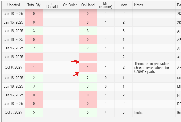

I managed to achieve this\* by applying the background color style to the cell data rather than the view itself, using a transform on the table data:

\*Technically, I didn't achieve the question stated in the title, which is why I'm not marking this as the solution. There still might be a case where one would want the view itself to expand to fit arbitrary row heights, so if someone knows how to do that, I'd still love to hear it.

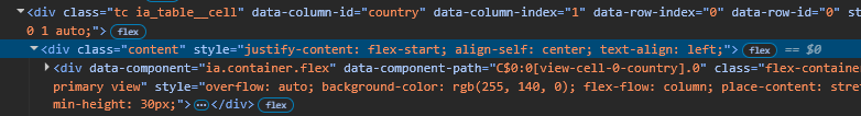

The style that determines that is one that is in between the style specified in the table props (cell or column) and the style of the root container in the embedded view.
 ![image](https://us1.discourse-cdn.com/inductiveautomation/original/3X/6/b/6bc55d6a7eaae7166f9ab441651000abf89431ae.png)
On the highlighted div, notice: `align-self: center`; that is the property that is making things display that way.
You can target that div with a CSS child selector and override the `align-self` property with an `!important` rule. Here's my style in the advanced style sheet:

Just what I was looking for, thanks! I prefer this over the data transform, which causes the embedded views to have to adjust their param references to account for the `value` key.
