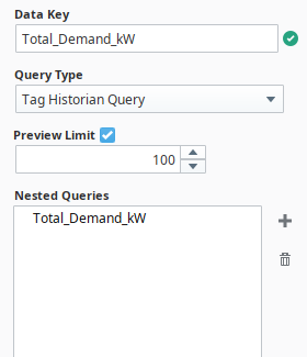

I think I’m missing something….
My Tag Historian Query
 ![image](https://us1.discourse-cdn.com/inductiveautomation/original/3X/2/3/23198dea272cd425612975daabd9853aa7b5aee2.png)
I’m assuming I need to replace the “data” in the system.date.format() to my Historian data source? So it would look like data['dayOfWeek'] = system.date.format(Total\_demand\_kW['t\_stamp'], "EEEEE").
But it doesn’t recognize Total\_demand\_kW that as a global name
Leaving it as “data” gives me an updateDataKeyError for the t\_stamp
**Author:** ![Ryan\_Deardorff](https://sea1.discourse-cdn.com/inductiveautomation/user_avatar/forum.inductiveautomation.com/ryan_deardorff/32/63815_2.png) [@Ryan\_Deardorff](https://forum.inductiveautomation.com/u/Ryan_Deardorff)\
**Post date:** [September 24, 2025, 8:25pm UTC](https://forum.inductiveautomation.com/t/table-conditional-formating/110937/6 "2025-09-24T20:25:04Z")
Try:
`system.date.format(data['Total_Demand_kW']['t_stamp'], 'EEEE')`
Whatever you see under "Data Sources" in the Key Browser should be available as a value within the `data` dict.

**Post date:** [September 24, 2025, 8:36pm UTC](https://forum.inductiveautomation.com/t/table-conditional-formating/110937/7 "2025-09-24T20:36:27Z")
Uhm, you have to iterate through your query result and construct a new one.....
`data['Total_Demand_kW']` will be a `QueryResult` object, which contains a dataset.
**Post date:** [September 24, 2025, 8:43pm UTC](https://forum.inductiveautomation.com/t/table-conditional-formating/110937/8 "2025-09-24T20:43:08Z")
Oh, right. Have to add the hour and day of week as new columns to that dataset...
**Post date:** [September 24, 2025, 9:40pm UTC](https://forum.inductiveautomation.com/t/table-conditional-formating/110937/9 "2025-09-24T21:40:58Z")
Lots of discussions with [QueryResults](https://forum.inductiveautomation.com/search?q=QueryResults%20order%253Alatest). Look for the ones with `system.dataset.toDataSet()` and/or `DatasetBuilder()`.
**Post date:** [September 24, 2025, 9:50pm UTC](https://forum.inductiveautomation.com/t/table-conditional-formating/110937/10 "2025-09-24T21:50:19Z")
As a tangent, I'd probably add a row to the dataset that defined whatever condition(s) you want to express as formatting.
That is - add a column that contains either `null` or `"OutOfRange"` or whatever, based on your full business logic (expressed in Python code within your script datasource). Then give the report row 'alternate' versions based on that column, and only deal with the _presentation_ within those alternate rows.
You'll save yourself a lot of grief down the road if the business logic ever has to change and you don't have to click between a hundred table rows and cells trying to find all the key expressions you set up.
