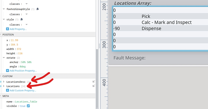

I am using Ignition v8.1 Perspective module and a table component to display servo locations and servo descriptions in a view that will act as a manual servo control faceplate (will use one of these views for every servo).
The servo locations are in one tag and the location descriptions are in another tag.
I bound both of those tags to custom properties on the table which then had a script transform to return a list.
 ![image](https://us1.discourse-cdn.com/inductiveautomation/original/3X/5/f/5fd17d3120825cc5e5b101627f3e564c23ac62bc.png)
Finally, I had a script on the props.data that would combine the two lists to display them in the table:

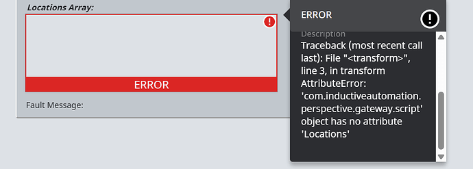

This works most of the time...but occasionally when i navigate to the view that this lives on, it seems like there is a race condition in which the data script that combines the two custom properties runs _before_ the two custom properties actually have values. Therefore I will get an error that looks like:
 ![image](https://us1.discourse-cdn.com/inductiveautomation/original/3X/2/a/2a5430681954cb9efd4f193665f2f39935af6efa.png)
Could anyone shed some light on the correct way to accomplish this? I would like this table to display the locations and descriptions and update if either of those change values.

I would agree with this assumption. What triggers the binding on `props.data`?
You could use an expression structure on `props.data` that point to your custom properties then update your transform script to handle things more gracefully. You could safely remove the `refreshBindings` since any change in these 2 tag bindings would trigger the `props.data`.

**Post date:** [December 9, 2025, 1:02pm UTC](https://forum.inductiveautomation.com/t/table-data-error-how-to-refresh-perspective-table-when-bound-data-changes/112684/7 "2025-12-09T13:02:37Z")
Can you screenshot the binding editor on your table data? Are you using an expression structure binding with your two custom props as key values?
Looking a the script producing the table data, I suspect not. (you should be using one. They have a default option set to wait for initial values to come in, but they also let the binding update whenever any of the key values change)
The reason however that you're seeing that error is because the two keys have bindings on them, and this defaults to setting them to be non-persistent. This means that the keys and their values themselves are not stored with the view's config, so when it loads in the client, the keys literally don't exist until the bindings run and create them

**Post date:** [December 9, 2025, 2:18pm UTC](https://forum.inductiveautomation.com/t/table-data-error-how-to-refresh-perspective-table-when-bound-data-changes/112684/8 "2025-12-09T14:18:58Z")
I believe this is working now! I have not used the expression structure before so I was missing the point for a while there but had a colleague @jrsandell94 give some pointers.
This is my set up now:
 ![image](https://us1.discourse-cdn.com/inductiveautomation/original/3X/f/9/f999c6deda4329636439a16388fbf0f3e74f9f7c.png)
And I am not getting any errors! The support from this community is unrivaled, thank you for your help @code_skin, @lrose, @nminchin .
