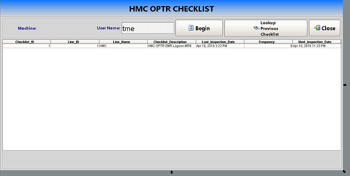

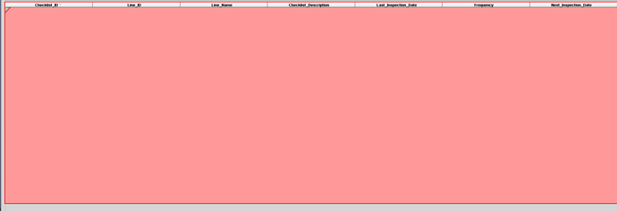

Hi I have encountered this issue, in Project it has red disconnected db in table.
 ![](https://us1.discourse-cdn.com/inductiveautomation/original/2X/b/b3e41f8787034e753016d43a6479c7684b63648b.png)

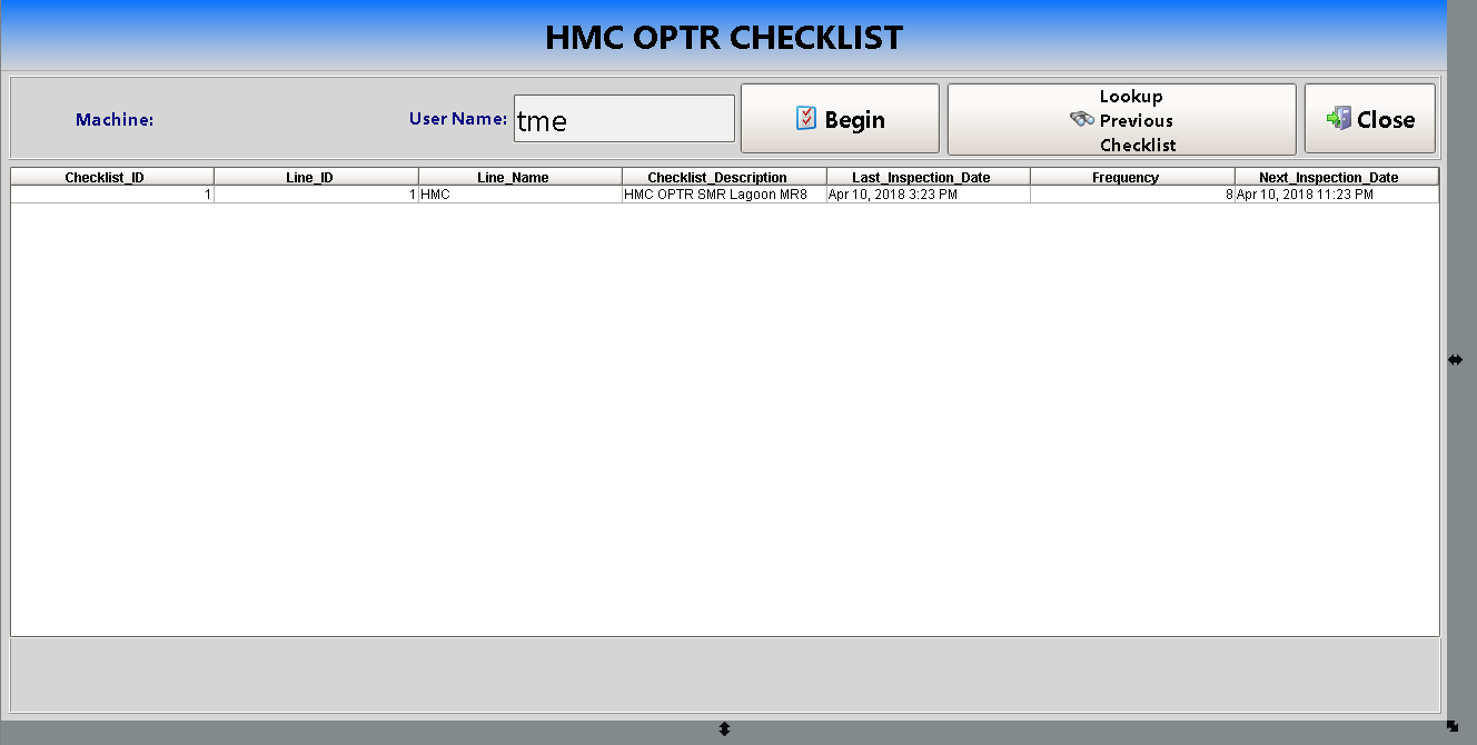

But in Ignition design it is connected.
 ![](https://us1.discourse-cdn.com/inductiveautomation/original/2X/3/3944c8a64d1961a9eedca806d2d9e9fdefb465d5.png)
**Post date:** [April 11, 2018, 12:33pm UTC](https://forum.inductiveautomation.com/t/table-disconnected-in-live-but-in-ignition-design-connected/17665/2 "2018-04-11T12:33:15Z")
Check in your project properties – you probably need to enable legacy queries.
**Author:** ![martinel37461](https://avatars.discourse-cdn.com/v4/letter/m/4da419/32.png) [@martinel37461](https://forum.inductiveautomation.com/u/martinel37461)\
**Post date:** [April 11, 2018, 12:35pm UTC](https://forum.inductiveautomation.com/t/table-disconnected-in-live-but-in-ignition-design-connected/17665/3 "2018-04-11T12:35:27Z")
We encountered the same problem and found two solutions in our environment.
Solution A: Change from SQL to a NamedQuery (my preference)
Solution B: Change the “Legacy Database Access” setting in:
&nbsp;&nbsp;&nbsp;&nbsp;&nbsp;&nbsp;Project \> Properties \> Permissions
Hopefully one of those will work for you.
