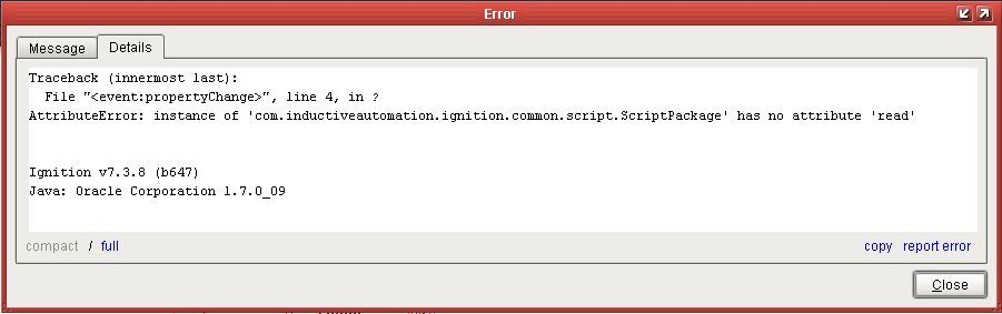

Ok so i tried that code and pasted it on the propertychange event and changed the other details like the tag, tagpath and table name and I got this error (errordetails.jpg) so what did was i tried to do it like this just
`if event.propertyName == "selectedLabel":
	if event.source.selectedLabel == "tag":
		tag = system.tag.read("tagpath")
		event.source.parent.getComponent("Table").addRow([1, tag.value])`
but i’m still having that error saying that there’s no ‘read’ attribute

Since you’re using 7.3.8 you’ll want to use system.tag.getTagValue() instead of system.tag.read().value. The read() function was added in 7.5.

Finally! It worked. ![:prayer:](https://us1.discourse-cdn.com/inductiveautomation/original/1X/e5a7e3b63facc151ea73e3b45db7bdb3d4bdc316.gif ":prayer:")
Last one though, I kind of already have the tables layout, 5 columns and 10 rows. I don’t want it to add rows just insert it to the rows and columns that are already there, what should i use instead of addrow?
