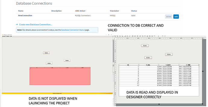

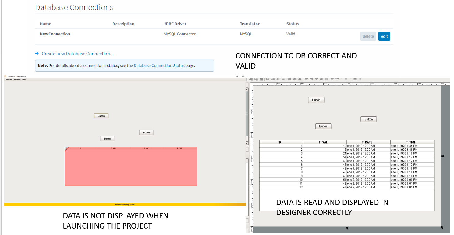

Hello all
I have an issue.
I am using a RPI 3 with the latest Debian OS and latest Ignition Server available for it. It runs well in it. I have also configured a MySQL Database (MariaDB) in the RPI and made a python code to fill it. Table is updating ok.
I have configured the Database Connection from the Ignition server page and it says it is valid. Also, when I create a table and link it to show a database table data, it does show it in the Ignition Designer.
However, when i launch the program, the database connection seems to not connect, and the data is not shown.
I upload some pictures regarding my proble.
The server is running on the RPI 3. The designer is run in my laptop (Windows 10 up to date) and i am also launching the server in my laptop for test.
If more information is needed i will look for it.
Thanks in advance

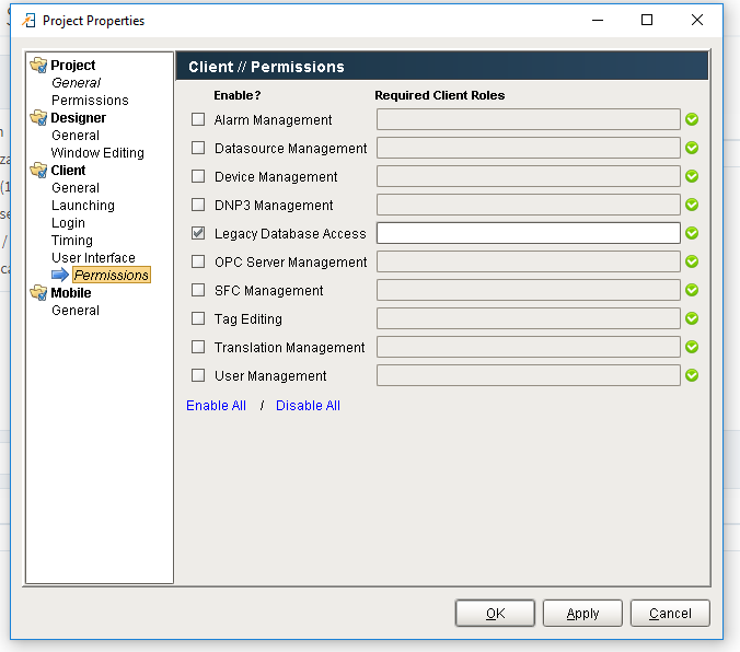

**Post date:** [January 3, 2019, 3:18am UTC](https://forum.inductiveautomation.com/t/table-not-connecting-when-launching-the-project/21655/2 "2019-01-03T03:18:15Z")
Look in your project’s security properties for legacy database query permission.
**Author:** ![jalvarado](https://avatars.discourse-cdn.com/v4/letter/j/ce73a5/32.png) [@jalvarado](https://forum.inductiveautomation.com/u/jalvarado)\
**Post date:** [January 3, 2019, 4:11am UTC](https://forum.inductiveautomation.com/t/table-not-connecting-when-launching-the-project/21655/3 "2019-01-03T04:11:51Z")
Here? Should I write something in the text box?
 ![](https://us1.discourse-cdn.com/inductiveautomation/original/2X/1/121932ebfe37ef14e6dd29f6ebe95042c8f47058.PNG)
**Post date:** [January 3, 2019, 4:22am UTC](https://forum.inductiveautomation.com/t/table-not-connecting-when-launching-the-project/21655/4 "2019-01-03T04:22:07Z")

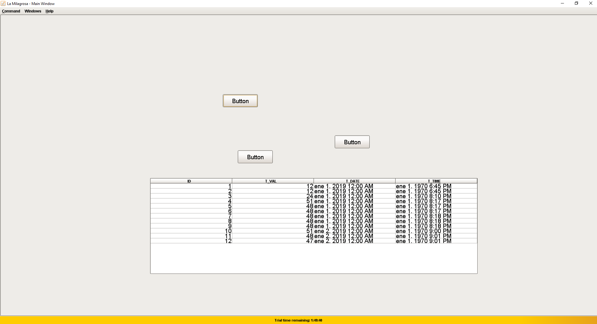

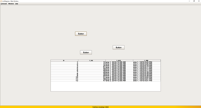

Thank you so much! It worked 😃
I didnt know MySQL in RPI was a legacy database…
 ![](https://us1.discourse-cdn.com/inductiveautomation/original/2X/7/73d86c856939fcb2920e0447305d945e393fee50.PNG)
**Author:** ![Brian](https://avatars.discourse-cdn.com/v4/letter/b/97f17d/32.png) [@Brian](https://forum.inductiveautomation.com/u/Brian)\
**Post date:** [January 3, 2019, 5:17am UTC](https://forum.inductiveautomation.com/t/table-not-connecting-when-launching-the-project/21655/5 "2019-01-03T05:17:46Z")
It’s not the database that’s legacy, it’s the access method. Ignition is moving toward named queries as the preferred method to interact with any database, as it’s more secure and robust.
