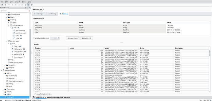

The Query runs well under testing returning data as expected. When binding to the Table it returns the Error\_Exception stating “Error\_Exception-(“java.sql.SQLSyntaxErrorException: Unknown column' ‘Jammed’ in ‘where clause’”)
I’m sure I'm missing something. script provided in TXT
 ![image](https://us1.discourse-cdn.com/inductiveautomation/original/3X/f/7/f7a76c2e872aed1ebd8cfe19a5d2b27e84a994f2.png)

Ah wait, you are using query strings with double quotes. Double quotes are used for identifiers in SQL, use single quotes. Any chance you are converting from MySQL to SQL server or PostgreSQL?
**Post date:** [September 5, 2025, 8:24pm UTC](https://forum.inductiveautomation.com/t/table-query-binding-returns-error-exception/110420/5 "2025-09-05T20:24:24Z")
You are using QueryString parameters to pass values. Don't do that. (You are somehow getting double quotes into your actual param, which are identifier delimiters in SQL, not value delimiters.)
Don't try to do your own delimiting of strings. Pass values as values. QueryString params are for SQL **structure** variation, and should **never** carry user-entered values.
