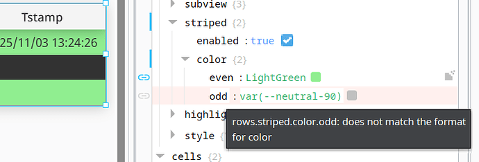

I'm trying to change a table so that the striping is slightly easier to see. There's an unanswered post from 2020 titled [Table striped color doesn’t accept css color variable](https://forum.inductiveautomation.com/t/table-striped-color-doesnt-accept-css-color-variable/40422). I have the same issue. If I type a color name, it works, but if I type a Built-in Theme Color (e.g. `--neutral-30`) it doesn't. Note that in the screenshot I have chosen a terrible color just to show the difference, not the color I'm actually trying to use.

Not all properties accept the theme color variables, like the xy chart, and I’m not sure why technically. If it does not accept the variable name, the next thing to try is wrapping it with `var()`, IE `var(–error)`.

I learned about `var` earlier today, but it doesn't work in this case. Thanks, though.

It does for me, I just tried it.

So two weird things. First, I tried it earlier to no avail. Second, now it is working, but still throws up a "does not match the color for format."

You’ll get the false positive error message many times using var(). It does work though, and you can ignore the warning.
The next step is to add your own variables to custom css files, then target the table selector in the advanced stylesheet to set the default colors to whatever you want. You can search the forum on how to do this.

Aha! Here's why it didn't work for me earlier. BOTH odd and even need to have a non-default value, or else it doesn't work. Then it also had the error message, so I assumed that was why it wasn't working.

You can see that it **is** working in your screenshot, despite the error message
