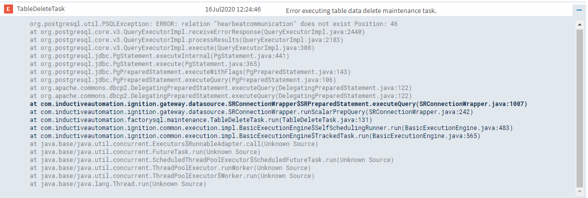

I have reoccurring error in the Logger:
 ![image](https://us1.discourse-cdn.com/inductiveautomation/original/3X/1/3/13c6009f54544993c5fe2b2b9381f71bf7543771.png)
org.postgresql.util.PSQLException: ERROR: relation “hearbeatcommunication” does not exist Position: 46

**Post date:** [July 16, 2020, 8:52pm UTC](https://forum.inductiveautomation.com/t/tabledeletetask-error-keeps-reoccuring/36787/2 "2020-07-16T20:52:47Z")
It’s a transaction group trying to delete records from its maintained table. The relationship error should hopefully explain itself - it’s unlikely to be something Ignition set up, but something else created in Postgres tied into the FSQL auto-generated table.
