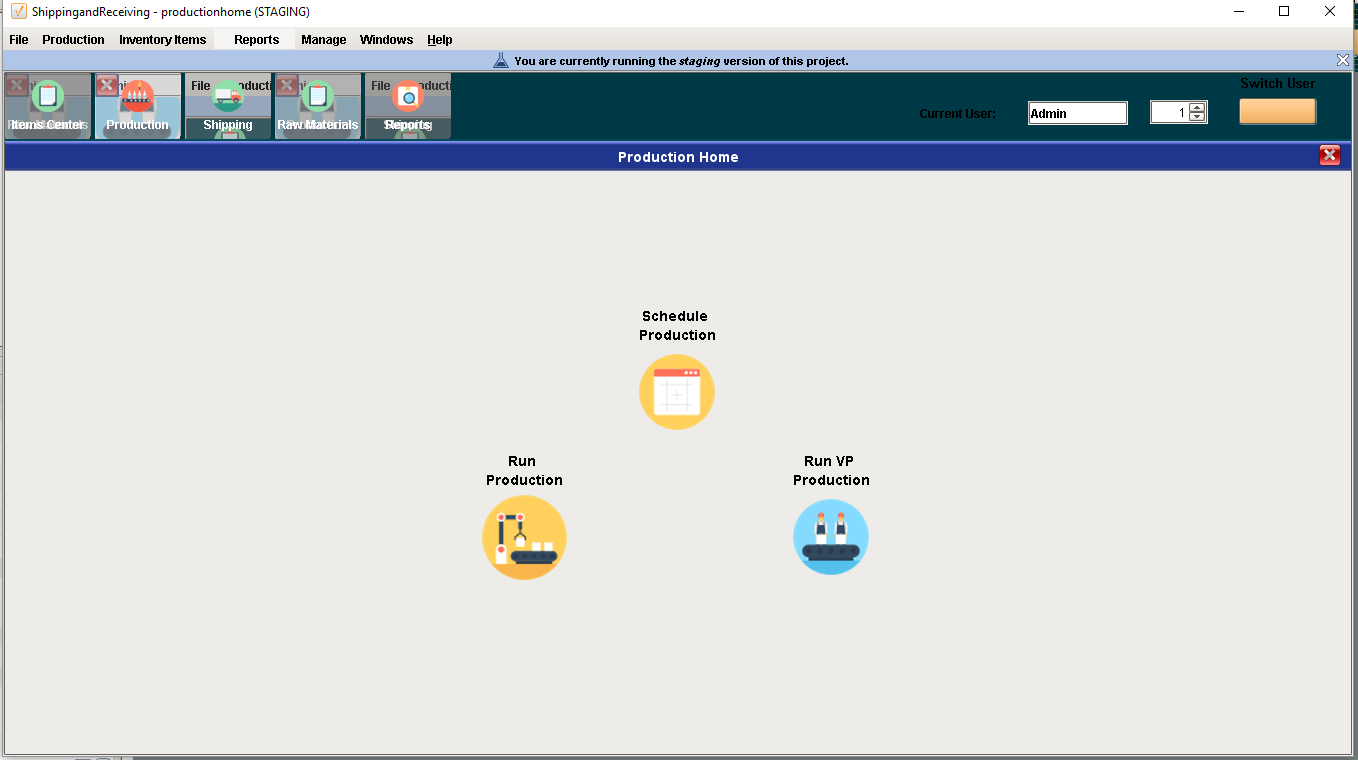

Im having the following problem with my client, i created a menu bar in the tabs strip, but every time the client opens the menu bar icons are not correct. there is a image repeated behind all icons, once i move the mouse over the icons the change correctly, and then menu icons look as they supposed to. but this happens every time i publish, and every time i open the client.
photos show the problem. please provide help with this. i have version 7.9.9
there is no scripting in the tabstrip, no binding either. and it happens on client in stage and pusblished mode
WITH ERROR PICTURES ON TABSTRIP
 ![menuiconserror](https://us1.discourse-cdn.com/inductiveautomation/original/2X/2/22aacd44a183231c27f09dec82e2eec1e320daa7.png)
AFTER I MOVE MOUSE OVER ICONS OR RESIZE SCREEN THEY GO CORRECT.
 ![menuerrorcorrect](https://us1.discourse-cdn.com/inductiveautomation/original/2X/7/7e35d6236c62baced3fb04aa518eae851e3ae442.png)
**Author:** ![juang](https://avatars.discourse-cdn.com/v4/letter/j/9dc877/32.png) [@juang](https://forum.inductiveautomation.com/u/juang)\
**Post date:** [February 18, 2019, 6:22am UTC](https://forum.inductiveautomation.com/t/tabstrip-error-in-client/22639/2 "2019-02-18T06:22:38Z")
so i figured out when this happens,
So tabstrip was send to full transparency, so i was using the background of the root container, for some reason when using. transparency in the tabstrip. the icons on the stip. show that problem.
