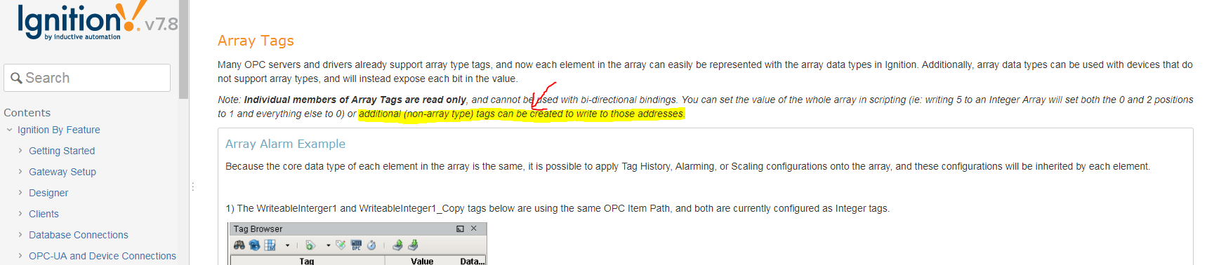

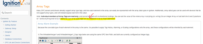

I can see in the user’s manual that it says “Individual members of Array Tags are read only, and cannot be used with bi-directional bindings.” But, I see this a couple of sentences later…
 ![image](https://us1.discourse-cdn.com/inductiveautomation/original/2X/5/5ccd65eb6b468401231e39553ebfd0cc3946b4fe.png)
Where do I find instructions or an example of using a “non-array type” tag to write to the array addresses? I would prefer not to change programming in the PLC (A-B Compact Logix 5370) in order to interact with Ignition.

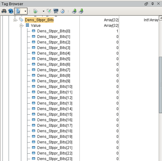

Here is what I have found:
Brought into the tag browser as an array I cannot write to or address individual bits. All I can do is read them. Correct?

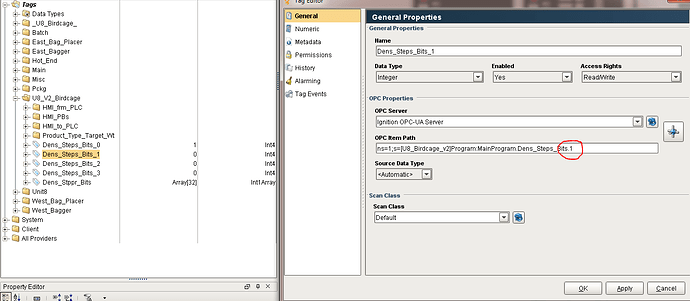

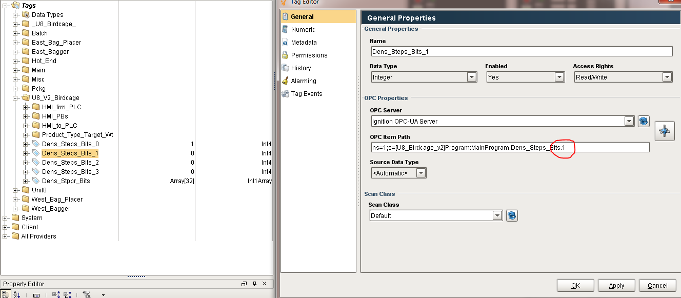

If I create a normal integer tag and append the path name with a “.(bit address)” then I am able to read and write to that specific address. Is this the best way to address or specify individual bits within an Allen Bradley DINT tag?
 ![image](https://us1.discourse-cdn.com/inductiveautomation/original/2X/a/a348d47d5e0aff0f54c40bbc5d7a74796de6dcd8.png)
**Post date:** [May 15, 2019, 10:08pm UTC](https://forum.inductiveautomation.com/t/tag-array-support-problem-with-the-write/11193/7 "2019-05-15T22:08:21Z")
> [@tim.newell](#):
Yes, if you need to write to them, this is the approach to use.
