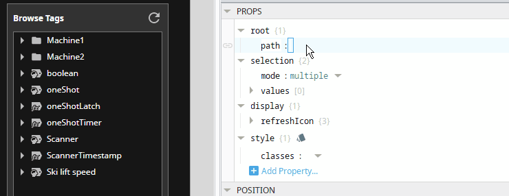

Hi,
Is there any option is their to enable and disable tag browser tree component?
Anyone please help me out
@paul-griffith any way to do that?
**Post date:** [May 10, 2022, 5:07pm UTC](https://forum.inductiveautomation.com/t/tag-browser-tree-component-enable-and-disable-option/59414/2 "2022-05-10T17:07:02Z")
Set `root.path: ''`.
![Tag browser blanker](https://us1.discourse-cdn.com/inductiveautomation/original/3X/c/2/c267b3b1ae86e0d5f0cd5ca538c0ba0b736be417.gif)
