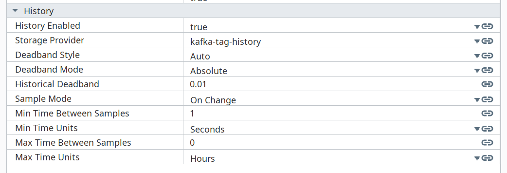

Is there a way to generate a tag change event "on write" such that if a tag holds one value, if the exact same value is written to it but at a different point in time which is later than its last update, a tag change event is generated?
The application is we use a kafka history sink to send data to central repository and we have been requested to send the value sent 4 times per hour on 0, 15, 30, and 45 minutes.
If we can make the tag change happen each time we write to the tag regardless of whether the value is changed or not, I will always end up with 4 values per hour in the central cloud DB.
If we can't do that, we will do interpolation on the query that pulls from the central repo.
**History Provider**
 ![image](https://us1.discourse-cdn.com/inductiveautomation/original/3X/2/6/265a1e31a8447e73685717db4042bc3f9cf22f87.png)

I'm not 100% sure on your setup, but tags have a `Quality Change` event that will trigger on anything that changes in the qualified value. This means the event fires for value, timestamp, or quality changes.
In the event the value is written to, but the value does not change, the quality change event still fires because the timestamp will update.
**Author:** ![nicholas.robinson](https://sea1.discourse-cdn.com/inductiveautomation/user_avatar/forum.inductiveautomation.com/nicholas.robinson/32/22188_2.png) [@nicholas.robinson](https://forum.inductiveautomation.com/u/nicholas.robinson)\
**Post date:** [December 7, 2022, 10:12pm UTC](https://forum.inductiveautomation.com/t/tag-change-event-on-write-when-tag-value-is-unchanged/67349/5 "2022-12-07T22:12:45Z")
What triggers it is if tag history on the tag is used and only when the value itself changes. In summary exactly how Ignition stores tag history.
Our setup is a Kafka producer module we wrote that can pick up and transmit tags, alarms, and audit events.
In case of tags, it is a history provider that can be used directly or with a splitter connection.
