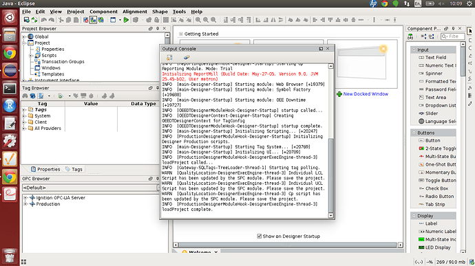

Hello all,
I am having problems with the designer - It freezes and crashes intermittently and cannot be revived until system restart, causing huge delay. I am currently running tests on my module, and the tests involve repeatedly creating and deleting tags for Arduino/Modbus devices.
Is it possible to create tags for a device using the SDK?
Thank you.

What OS are you using when your Designer crashes? (and what version of Ignition?)
Is there any output in the Designer’s console when it crashes? (You might not be able to copy it, but you should be able to get a screen shot.)
**Author:** ![nifemi](https://avatars.discourse-cdn.com/v4/letter/n/a5b964/32.png) [@nifemi](https://forum.inductiveautomation.com/u/nifemi)\
**Post date:** [May 6, 2015, 8:42am UTC](https://forum.inductiveautomation.com/t/tag-creation/9979/5 "2015-05-06T08:42:25Z")
Hello Kathy,
I’m on Ubuntu 14.04, and the console freezes along with everything else… no useful information.

I made a bug ticket to check out your freezing issues. I haven’t seen this in Ubuntu, but when I’m running Ignition in a VM I’m not doing much outside of Ignition, so my clipboard is empty.

The designer issue is solved in 7.8.
