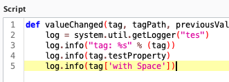

**Post date:** [June 6, 2022, 3:35pm UTC](https://forum.inductiveautomation.com/t/tag-custom-property-access/60409/4 "2022-06-06T15:35:26Z")
I think just `tag.propertyName`.

But with two properties I was able to read them directly off the `tag` object in the event script:
 ![image](https://us1.discourse-cdn.com/inductiveautomation/original/3X/a/c/acb0775922477bffd415eafc5b7c2ba1dc2564b9.png)
 ![image](https://us1.discourse-cdn.com/inductiveautomation/original/3X/d/4/d46cc4e50f7b411caee7d41c754e88f654c9d71e.png)
 ![image](https://us1.discourse-cdn.com/inductiveautomation/original/3X/6/4/645722d53b739a72abe081ae0e6aee35d54b280f.png)

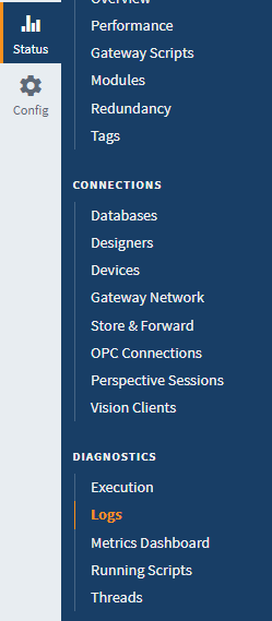

Thanks. I was also able to find it on the gateway here:
 ![image](https://us1.discourse-cdn.com/inductiveautomation/original/3X/5/4/54d3634439b10afd24c1cc20fbbb521df3eac90c.png)
