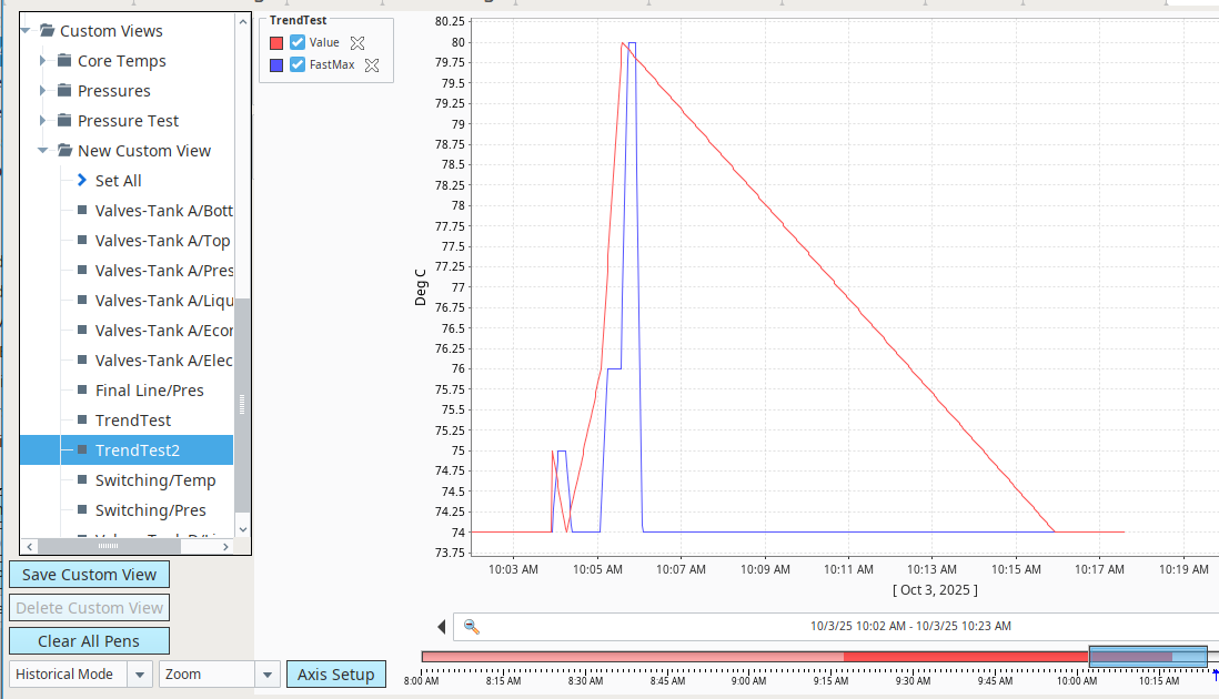

I’m struggling to get EasyCharts to display accurate analog history data.
The data compression algorithm is not (IMHO) working as it should. The description of the algorithm is a bit vague when it refers to “previous value” I’m not sure if it’s referring to the previously logged value, or the previously scanned value. In either case, the algorithm doesn’t work as it should.
I’ve historized two idential tags. One has a 10 minute Max Time Between Samples, and the other has a 5 second Max Time Between Samples
 ![history_tags](https://us1.discourse-cdn.com/inductiveautomation/original/3X/2/9/29bef221f4b4211852713c330fa9a92af60d61d0.png)
In the slower trend, the final change to value 74 is shown as a linear interpolation over the Max Time Between Intervals time span. I don’t think this is what anyone wants from their trend data. The history compression algorithm should have immediately logged a value to the database when the value dropped to 74.

**Post date:** [October 3, 2025, 3:55pm UTC](https://forum.inductiveautomation.com/t/tag-history-algorithm-bug/111175/2 "2025-10-03T15:55:19Z")
Looks like you may be running into this issue.
> [@Power Chart Interpolation](https://forum.inductiveautomation.com/t/power-chart-interpolation/111041/6):
> This topic came up a lot during training sessions. The main reason I've found that causes this is actually in the tag historical configuration, specifically the deadband style property. There are three options, auto (default), Analog and Discrete. Auto will choose either Analog or Discrete based on the tag type. Basically anything with a floating point is set to analog. An analog deadband style always assumes a linear path. Think of temperature, it's impossible to jump from one temp to anothe…
Yes I know the linked thread is primarily about the perspective Power Chart, but if you scroll down you will see that people see the same issue with the Easy Chart. That and the actual issue in that thread was a tag configuration issue.

**Post date:** [October 3, 2025, 4:15pm UTC](https://forum.inductiveautomation.com/t/tag-history-algorithm-bug/111175/3 "2025-10-03T16:15:24Z")
Thanks for the heads up to that post.
I’ll be using Discrete deadband style in the future.
**Post date:** [October 3, 2025, 5:00pm UTC](https://forum.inductiveautomation.com/t/tag-history-algorithm-bug/111175/4 "2025-10-03T17:00:01Z")
This needs to be a sticky…I started setting all analog tags to discrete about 3 years ago because of this very behaviour. I’m not sure either the use case for the way it operates in analog/auto.
