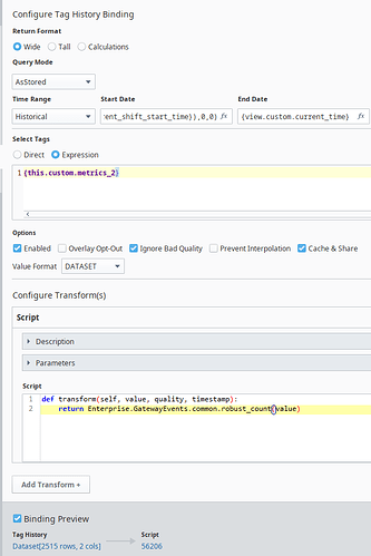

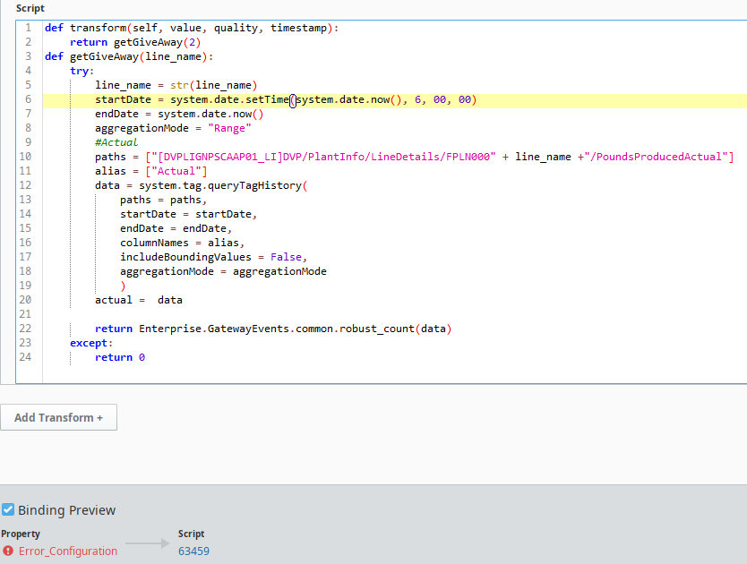

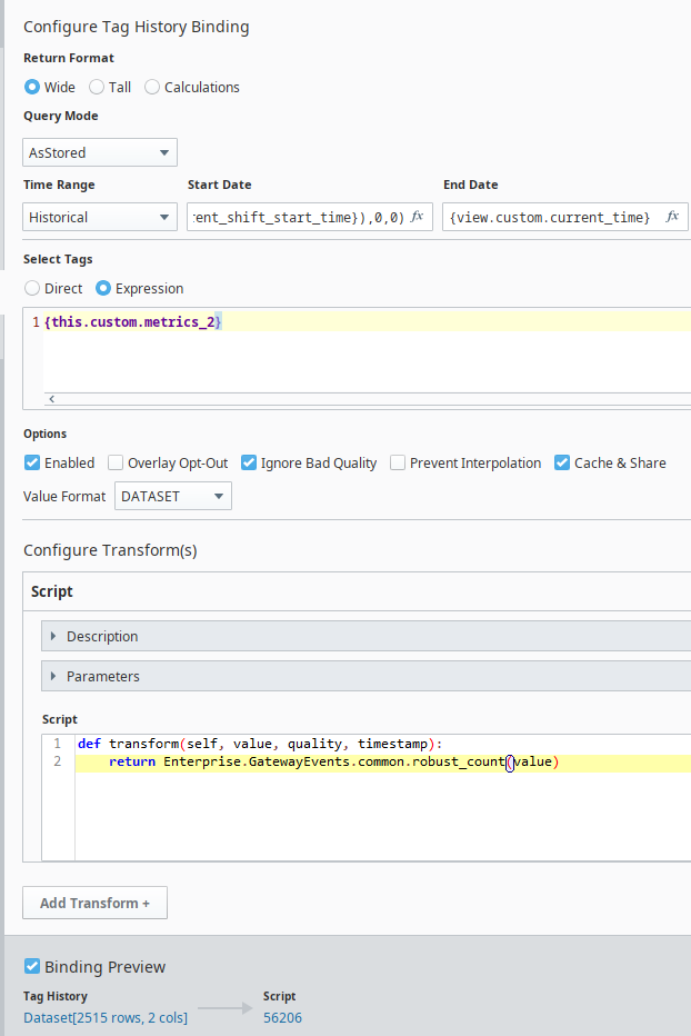

I'm writing a script using the system.tag.queryTagHistory function that replicates the Tag History binding.
However, the returned values don't match. the system.tag.queryTagHistory is providing 300+ rows than the Tag History Binding, even though they have the same tag path and timeframe.
I could use some help on this to make sure that they'll match. Below are some pictures to illustrate my problem. Thank you in advance!
![image](https://us1.discourse-cdn.com/inductiveautomation/original/3X/4/0/4093ff197117cea7c94703ceede8e4713743d9b6.png)
 ![image](https://us1.discourse-cdn.com/inductiveautomation/original/3X/6/7/6750d032644a8f61cf852ea48bca2dfd6d02244b.png)
 ![image](https://us1.discourse-cdn.com/inductiveautomation/original/3X/c/e/ce2cf8bf166d0e5ee416bd3888a9bfae11291a0e.png)

It looks like your one query is returning results without interpolation and the other is returning with an aggregate. I only glanced at this so I might have missed something.
search the documentation link for "Raw Data Queries"
Documentation
[https://docs.inductiveautomation.com/display/DOC81/Configuring+Tag+History](https://docs.inductiveautomation.com/display/DOC81/Configuring+Tag+History)

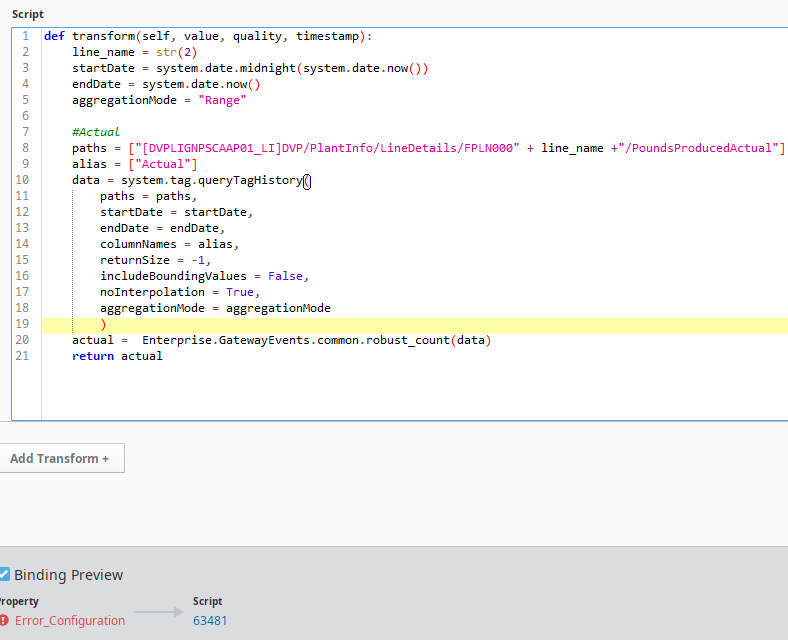

I added the returnSize and removed the interpolation, but it still didn't work.

I found the problem. It was on my time range.
