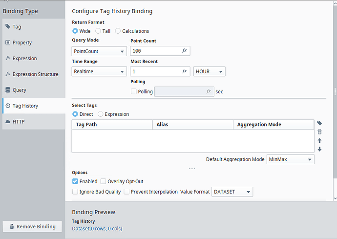

What is the polling rate for the tag history binding in perspective?
 ![image](https://us1.discourse-cdn.com/inductiveautomation/original/3X/9/0/906e8a840f1aa0d4ef5dd3dbf282f4c7d62aaa0b.png)
**Post date:** [July 24, 2020, 8:56pm UTC](https://forum.inductiveautomation.com/t/tag-history-binding-poll-rate/37069/2 "2020-07-24T20:56:33Z")
Whatever you have it set to:
 ![image](https://us1.discourse-cdn.com/inductiveautomation/original/3X/3/7/372e7d6e178bf1592c6e88952004c6dcd9478068.png)

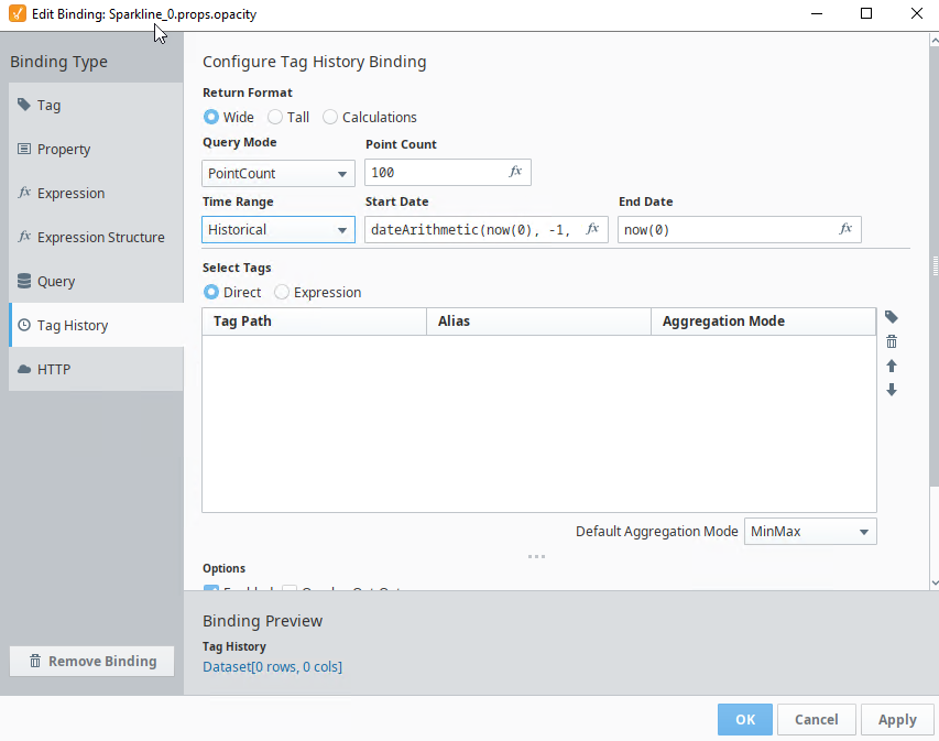

Sorry, wrong screenshot, I wanted to know for the historical time range
Dont see the polling option for historical.
 ![image](https://us1.discourse-cdn.com/inductiveautomation/original/3X/3/e/3e7233d5fa104550144490e508a1d3237857c453.png)
**Post date:** [July 24, 2020, 9:15pm UTC](https://forum.inductiveautomation.com/t/tag-history-binding-poll-rate/37069/4 "2020-07-24T21:15:53Z")
For historical ranges, there’s no polling - the query is run for whatever time slice is given. If you change the end date binding to a binding that poll (eg, `now(5000)` then it’ll update to the current time every five seconds, and that becomes the de facto poll rate for your binding.
**Author:** ![ankitkarwa21](https://avatars.discourse-cdn.com/v4/letter/a/48db29/32.png) [@ankitkarwa21](https://forum.inductiveautomation.com/u/ankitkarwa21)\
**Post date:** [July 24, 2020, 10:05pm UTC](https://forum.inductiveautomation.com/t/tag-history-binding-poll-rate/37069/5 "2020-07-24T22:05:59Z")
Got it. Thanks @paul-griffith
