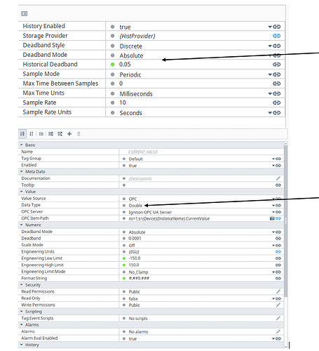

**Author:** ![devaraj.v](https://avatars.discourse-cdn.com/v4/letter/d/ecccb3/32.png) [@devaraj.v](https://forum.inductiveautomation.com/u/devaraj.v)\
**Post date:** [October 3, 2025, 7:13am UTC](https://forum.inductiveautomation.com/t/tag-history-data-logging/110965/16 "2025-10-03T07:13:40Z")
Figure:1

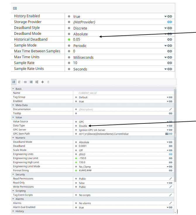

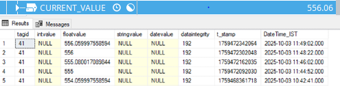

Problem 1: For some tags it is working fine. For example (Figure:2), if my tag value is 556 and the deadband is 0.05, the value gets logged whenever it changes by more than ±0.05 . But for some other tags(for example refer Figure:1), even though I use the same settings, the value logs as null every 10 seconds, which should not happen. Ideally, whenever we change the value, it should follow the deadband. However, if we don’t change the value, it should not log anything at all—instead of logging null.
Figure:2
 ![image](https://us1.discourse-cdn.com/inductiveautomation/original/3X/7/2/7273eee0281f83d6eb997242df2f6fb5566514fc.png)
Problem 2: I changed my tag value to 556.06, but instead of showing the rounded value, it displays a long decimal like 556.059997558594. Is there any way to display the correct changed value?(Refer Figure 2)
**Author:** ![David\_Stone](https://sea1.discourse-cdn.com/inductiveautomation/user_avatar/forum.inductiveautomation.com/david_stone/32/79749_2.png) [@David\_Stone](https://forum.inductiveautomation.com/u/David_Stone)\
**Post date:** [October 3, 2025, 10:06am UTC](https://forum.inductiveautomation.com/t/tag-history-data-logging/110965/17 "2025-10-03T10:06:42Z")
> [@devaraj.v](#):
Please do some research around how computers store decimals as floats. For example:
> **[IEEE Standard 754 Floating Point Numbers - GeeksforGeeks](https://www.geeksforgeeks.org/computer-organization-architecture/ieee-standard-754-floating-point-numbers/)**
> Your All-in-One Learning Portal: GeeksforGeeks is a comprehensive educational platform that empowers learners across domains-spanning computer science and programming, school education, upskilling, commerce, software tools, competitive exams, and...
Ignition is behaving in the industry standard way when it stores float values. There are many ways of dealing with this behaviour. The critical thing is that Ignition is storing this value correctly.

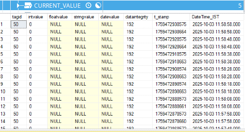

**Post date:** [October 3, 2025, 11:06am UTC](https://forum.inductiveautomation.com/t/tag-history-data-logging/110965/18 "2025-10-03T11:06:12Z")
> [@devaraj.v](#):
The value isn't logging as null, it's logging as 0. That you are showing the current value to be 5 and a logged value of 0, makes me think there is something else going on, like this being a different tag, or not truely an integer value.
Also, please show the history configuration for this tag, so we can see if maybe you've missed something, in the setup.

**Post date:** [October 3, 2025, 1:41pm UTC](https://forum.inductiveautomation.com/t/tag-history-data-logging/110965/20 "2025-10-03T13:41:42Z")
I would recommend that you call into support and have them take a look. I don't think I've ever had a tag that logged as both an Integer and a Float.
