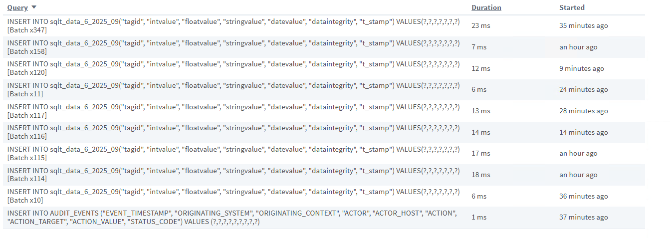

I keep getting this message “
| default No information could be found for historical system 'ignition\_master\_svr'. Please verify that the system is correctly storing data to the specified database ('SQL\_Server').” My server is connected and online and my history connection is fine as well. Rebooted Ignition and SQL Server | |

looks like Ignition is trying to sqlt\_data6\_2025\_09 but in my tables I am seeing
 ![image](https://us1.discourse-cdn.com/inductiveautomation/original/3X/c/d/cdec9cd1a5a52f627c2400b6a9b67a9f6c2acfdc.png)
 ![image](https://us1.discourse-cdn.com/inductiveautomation/original/3X/0/e/0e1d9dd76065a67885eca030fe2bf4cea25e24af.png)

to correct issue my only finding I could come up with was to delete my server connection, then connected again forcing ignition to create a new partition and tags started writing again.
