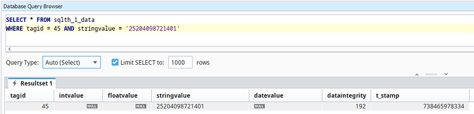

Hello,
I started historizing a tag earlier this morning. Was wanting to grab a little more info on a particular record, but the t\_stamp (738465978334) that I am getting back for it is giving me a date back in 1993. Was wanting to see if I could get some help figuring out why
 ![image](https://us1.discourse-cdn.com/inductiveautomation/original/3X/8/0/809008b40354d5c63f942045ff97f9b3e76e445f.png)
**Post date:** [July 24, 2025, 7:51pm UTC](https://forum.inductiveautomation.com/t/tag-history-tstamp-question/108926/2 "2025-07-24T19:51:09Z")
That usually means the OPC server supplying that tag has a broken clock. An accurate clock is **required** in OPC.

> [@Ryan\_Amyette](#):
> 738465978334
Ok, that makes sense. Thank you for the reply
