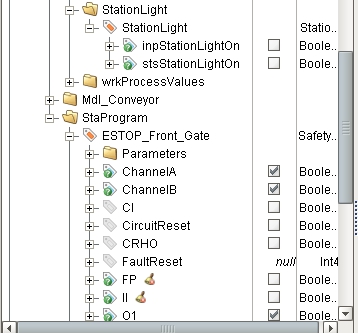

Hello,
Newbie here! I have a problem with refreshing tags. I use 2 VM instaled on ESX, the first is used to store projects (called HMI) and the second serves as a remote tag provider(called TAG) to first one. So plc drivers are connected to TAG VM, and HMI VM reads it via remote tag provider.
Here is the problem:
 ![652](https://us1.discourse-cdn.com/inductiveautomation/original/2X/c/ccad1a2b1ea12d4d598952accefd4327b17a832f.jpeg)
After the reset of the virtual machine with the tag server the situation is stable
This are my ignition parameters:
Environment
Process Id 904
Operating System Linux | amd64
Java Version 1.8.0\_171-b11
Available Disk Space 20gb / 27gb
Systems
Performance 26% CPU | 989mb
Redundancy Not configured
Modules 19 installed
Tags 7,405 tags
Host PC with TAG and HMI VirtualMachines is i7-6700 3,4GHz. SSD disc and 16GB memory.
After a moment of work on the project, the tags start to flash - they refreshing so slowly that for a moment they lose their current state, then they see a green question mark in place of the tag and then go out - as in the picture above. What is the problem? What can be improved to make it work more efficiently?
Thank you for replays.

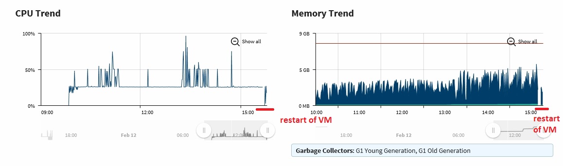

Here is screen including performance.
