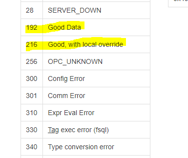

**Author:** ![denis.palomanes](https://avatars.discourse-cdn.com/v4/letter/d/779978/32.png) [@denis.palomanes](https://forum.inductiveautomation.com/u/denis.palomanes)\
**Post date:** [February 1, 2019, 3:37pm UTC](https://forum.inductiveautomation.com/t/tag-quality-isgood-specific-codes/22283/3 "2019-02-01T15:37:39Z")
Hello,
Thank you for the quick answer, but I have seen the document but it doesn’t specifies that the isGood() function returns only the codes 192 and 216. The question is; the isGood() function only returns 192 and 216?
Thank you,
![image](https://us1.discourse-cdn.com/inductiveautomation/original/2X/d/de80f7fb00770fb2767bc0b42e90519532d91bc0.png)
**Post date:** [February 1, 2019, 4:42pm UTC](https://forum.inductiveautomation.com/t/tag-quality-isgood-specific-codes/22283/4 "2019-02-01T16:42:47Z")
The entire point of calling out to the `isGood()` method is that you _don’t_ care what specific quality code you have - you’re essentially asking the individual code whether it is considered “good” or not.
That said, the quality codes that `isGood()` will be true for are 192 (good data), 216 (good with local override) and 320 (good, "provisional), meaning that the value may not be good for an indefinite duration.
