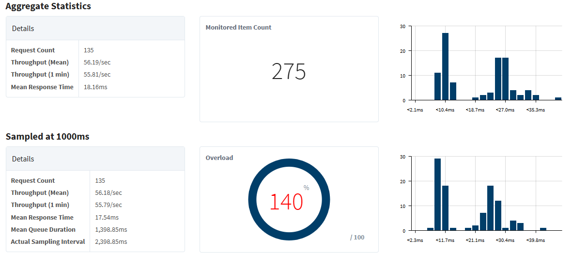

**Post date:** [July 9, 2025, 1:52pm UTC](https://forum.inductiveautomation.com/t/tag-refresh-rate-with-mitsubishi/108270/5 "2025-07-09T13:52:40Z")
I just went in and changed all refresh rates to 1000ms and it sits right around 140% overload. I have attached a screenshot of the page with everything set to 1000ms.
 ![image](https://us1.discourse-cdn.com/inductiveautomation/original/3X/a/7/a730e0fa59532e9f9c5317313ae7723a9453be1a.png)
**Post date:** [July 9, 2025, 1:54pm UTC](https://forum.inductiveautomation.com/t/tag-refresh-rate-with-mitsubishi/108270/6 "2025-07-09T13:54:30Z")
275 tags requiring 135 requests probably means the addresses you are reading are poorly co-located. Reading contiguous addresses is better for performance.
**Author:** ![Shaun\_Thobe](https://avatars.discourse-cdn.com/v4/letter/s/e19b73/32.png) [@Shaun\_Thobe](https://forum.inductiveautomation.com/u/Shaun_Thobe)\
**Post date:** [July 9, 2025, 2:42pm UTC](https://forum.inductiveautomation.com/t/tag-refresh-rate-with-mitsubishi/108270/7 "2025-07-09T14:42:40Z")
I have always known reading from continuous registers is faster and I did have registers scattered throughout the program because I have the PLC broken out into register groups but it wasn't 135 different groups. To test this, I set the 275 tags to read from 2 continuous blocks. It is actually saying 5 but close enough. After this the overload went to 0-1% so it definitely looks to be related to gaps in the registers.
So then the question is why 135 requests. I did some additional testing as I had a suspicion. In Mitsubishi, if you let the PLC auto assign tags to registers it will assign only the tags it needs for all data types but strings get funky. If you have an even length string, the PLC will auto assign the string length divided by two plus one. (Example: String of length 12 will assign 7 registers). If you have an odd length string, the PLC will auto assign the string length divided by two and round up the one half. (Example: String length of 11 will assign 6 registers.)
This is due to how Mitsubishi processes strings. All of the commands we can use to handle clearing, setting, checking, comparing, etc of string data will start with the starting register and then go to the first zero or null byte even though you specify a string length. I don't know why it works that way but it does unfortunately. However, knowing this, we have always had a habit of adding an extra register after every string so we don't accidently pull information from two strings that are "continuous" in register count.
With that said, I changed all strings to be 100% continuous in how registers would be auto assigned and the count went to 5 requests. This means I missed a couple but it still shows and explains what is happening.
Now seeing and knowing this means I am going to have to greatly re-think how to group everything into as few of groups as possible to interface with Ignition.
Thank you for your quick replies and the tips on finding this! I have some work to do now!
