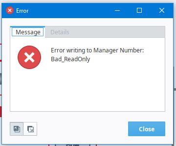

There is also a numeric entry field tied to an tag with security. When a user without write access tries to change the value, the system shows this error message:
![Capture](https://us1.discourse-cdn.com/inductiveautomation/original/3X/e/9/e944ee39f7e161063f3bf53299abb5839071c2bf.jpeg)
Shouldn’t the behavior of the system be consistent among components? According to the documentation, it is preferable to set the security at the tag level rather than component level.

I've had similar frustrations with this, but I think I can help make sense of it. The way I view it, a task like using a numeric input or changing a property value has a very concrete goal - change the value. If something prevents you from doing so, an exception is thrown.
Scripting functions are very much the opposite - ideally they throw an exception only as a last resort. There are plenty of conceivable reasons you might want a script continue even if writeBlocking does not succeed. The function was built with this in mind. [In the docs](https://www.docs.inductiveautomation.com/docs/8.1/appendix/scripting-functions/system-tag/system-tag-writeBlocking), you'll see it returns a list of [QualityCodes](https://www.docs.inductiveautomation.com/docs/8.1/appendix/reference-pages/scripting-object-reference#qualitycode). It's up to us to interpret these codes within our script and throw an exception if needed.
