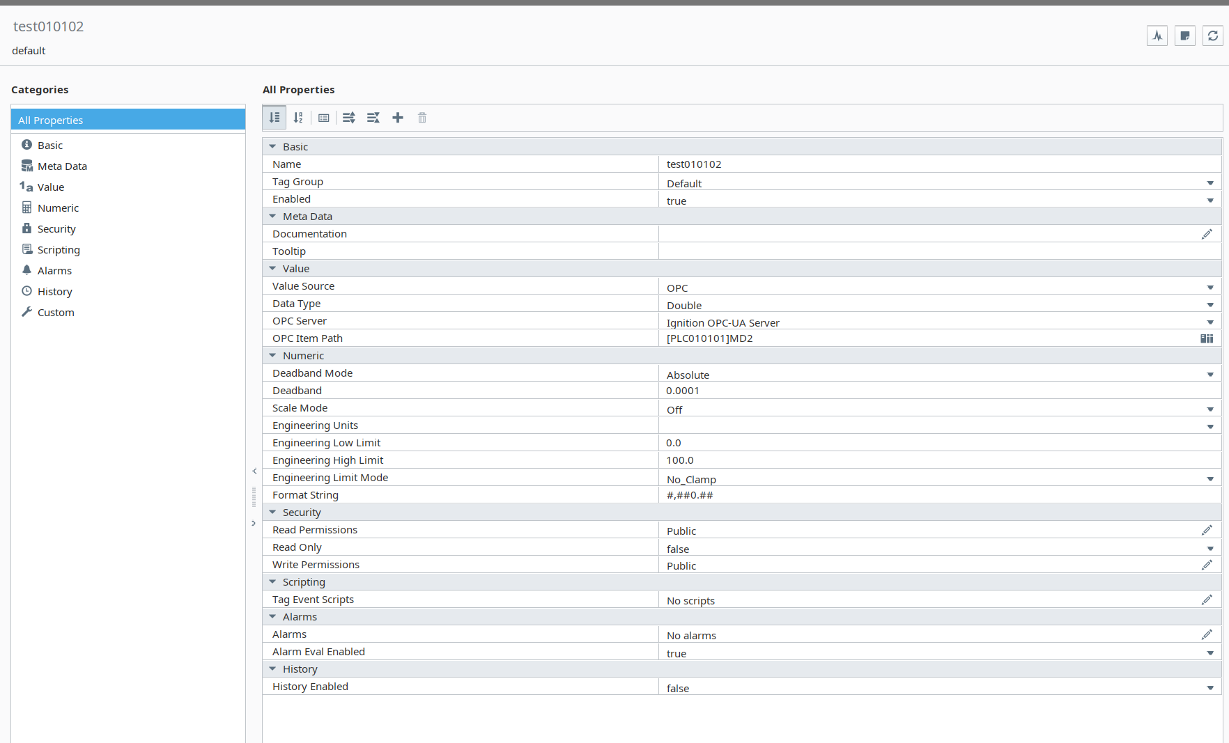

My tag in Ignition shows over 1 billion. Anyone else come across this problem?
 ![image](https://us1.discourse-cdn.com/inductiveautomation/original/3X/1/2/12cd91378369a2feda601597db7c568f83c4b4b0.png)
 ![image](https://us1.discourse-cdn.com/inductiveautomation/original/3X/7/2/729117692566822408757d1cf917b165815065f7.png)

When I change the OPC Item Path to another adress (IW) I get the expected value up. But when I use the adress (MD) I get the one billion value up.

 ![image](https://us1.discourse-cdn.com/inductiveautomation/original/3X/e/c/ec0f741665fd2f79a4140c7d609d65656932dff1.png)

Change the tag type from double to float.
Float is 32-bit (like REAL in S7), double is 64-bit...
Then use in OPC Item Path: `[plc10101]MREAL2`
[https://www.docs.inductiveautomation.com/docs/8.1/ignition-modules/opc-ua/opc-ua-drivers/siemens#data-type-syntax](https://www.docs.inductiveautomation.com/docs/8.1/ignition-modules/opc-ua/opc-ua-drivers/siemens#data-type-syntax)

I have tried that, but it doesent seem to fix the problem..
 ![image](https://us1.discourse-cdn.com/inductiveautomation/original/3X/2/5/2559a691faeb6fdb744635a93692f6fe84e82be9.png)
 ![image](https://us1.discourse-cdn.com/inductiveautomation/original/3X/3/c/3c335b855b33b3afa20d40ec36e2b4100ac7b3a3.png)
**Post date:** [April 23, 2024, 11:58am UTC](https://forum.inductiveautomation.com/t/tag-value-is-not-the-same-that-i-have-in-the-plc/89272/9 "2024-04-23T11:58:14Z")
Your screenshot still shows `MD2` as the OPC Item path. You need to change that as @zxcslo directed.

Oh sorry, didnt realise!
Thanks zxcslo, and thanks pturmel aswell!
