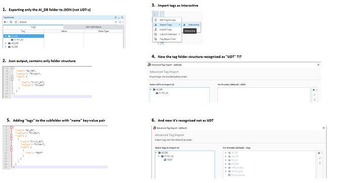

Hi!
Trying to create tag folder structure by importing modified json export.
However… it seems like if there is no “name” under a folder, it’s recognized as UDT
See the picture below, tried to capture improtant step in 6 parts.
 ![image](https://us1.discourse-cdn.com/inductiveautomation/original/3X/d/e/debaf3850810c3948924ed1d2d2c850c9b3e66d1.png)
