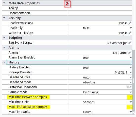

I am facing a very weird issue when using the tag history feature in Ignition 8.1 perspective. When, I enable historical logging in a tag (float datatype) and do the configuration i.e. make the the sampling mode “On Change”, Minimum Sampling Time 1 sec and Maximum Sampling time 3 Hr _(picture below)_.
After doing this, when the tag starts running and getting different values in it, **no values are logged in the database** and on Power Chart the trend of that tag starting operating real-time with respect to the tag value (no history maintain). And, as I turned off the tag value the trend also stopped and in database no values were stored.

When I changed the **Maximum Sampling time** to 1 sec, 2 sec, 500 ms. I started getting values in the database according to the above set rate and the tag history starts maintaining. Also, the Power chart is showing historical trend.
The thing I know is, maximum Sampling time is for the max sampling rate. The sampling of tag values should be depend on “Minimum sampling rate”. But I don’t know why this is happening 😐
I also tried deleting the tag, testing this on other tags…But the issue is same. Kindly, help me out in this please.

Did you notice that History has a separate deadband?

The minimum time between samples prevents tags that update/change faster than this rate to only sample at that rate. For instance, if you set this to 5 seconds and your tag changes every second, it will only be logged once every 5 seconds. the max time between samples ensures that a value that doesn’t change outside of the historical deadband gets logged at least once per that period. In your instance, it will force it to be logged every 3 hours even if it doesn’t change outside of the deadband range.
It also looks like you are scaling this raw value from a range of 0-100 to a scale of 0-1. Since your historical deadband is 0.1, this requires the raw value to move by units of 10 for new values to be logged as well.
