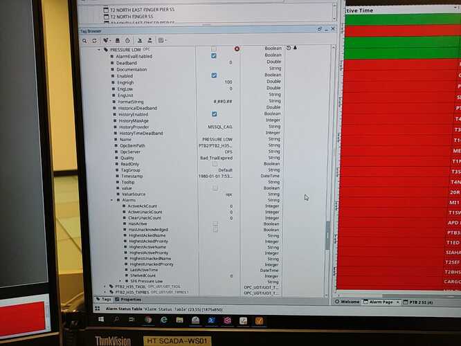

Greetings,
Last few days ago, our team faces an issue regarding tags quality error-Bad\_TrialExpired (currently using Ignition 8) even though the gateway is being licensed partially (not all modules are activated). The tags are from the Schneider OFS OPC UA server. The problem shouldn’t occur as the OPC-UA module is being activated right? We try to restart the PC, but the problem still there. Did we miss out on anything in the module or setup?
 ![WhatsApp Image 2020-12-09 at 11.59.30 AM](https://us1.discourse-cdn.com/inductiveautomation/original/3X/e/6/e68bbcbbd11ff9f741927d23e235811a8bba913f.jpeg) ![WhatsApp Image 2020-12-09 at 3.54.00 PM](https://us1.discourse-cdn.com/inductiveautomation/original/3X/0/a/0a2a4337b6c5a27468ca83ffe65a6d7823799a28.jpeg)
**Author:** ![kairongsen](https://avatars.discourse-cdn.com/v4/letter/k/eb9ed0/32.png) [@kairongsen](https://forum.inductiveautomation.com/u/kairongsen)\
**Post date:** [December 15, 2020, 3:28am UTC](https://forum.inductiveautomation.com/t/tags-show-bad-trialexpired-even-thought-the-gateway-is-licensed/41384/2 "2020-12-15T03:28:47Z")
DA COM module issue. After you activate it then the problem solved.
