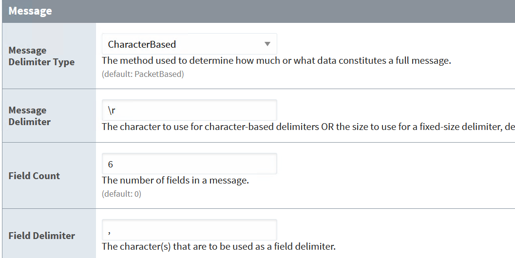

Hello,
I am using a PUSR rs232 serial TCIP Server. I have the data formatted within the ignition device, and am not having any problems with this, but the device stops receiving data after a certain amount of time.
The ignition device remains connected but only works again after I restart the device or resave changes. I have tried to set the inactivity timeout, but it will lose data if a signal is received while it is restarting due to inactivity.
 ![image](https://us1.discourse-cdn.com/inductiveautomation/original/3X/e/5/e52d49bb5f1116396fb15bd48dff025bcb06be9e.png)

If your device can send more than one message in the poll rate for the tag group, then the TCP device will not be suitable for your application. You would need to use java sockets instead, with a long-lived listening thread. (Which has complications--search for that here on this forum.)

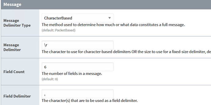

without resetting the device, I used RealTerm software. this is what the data looks like:
28845,0,start ,16494261,13:39:48,02/02/26
28845,0,end ,16509368,13:40:14,02/02/26
28845,0,start ,16524381,13:40:40,02/02/26
28845,0,start ,16545594,13:41:16,02/02/26
![image](https://us1.discourse-cdn.com/inductiveautomation/original/3X/4/8/48d8fcd2c49a5609c5caf33a38ce33d311c5eb4e.png)
There is definitely nothing wrong with my tcp server, this must be ignition.

Your actual messages are terminated with carriage returns. Be sure you use that in your device configuration.
However, you have a bigger problem: you can get two messages in a single packet. This will cause the driver to lose all but the last message.
More than likely, your source device is not setting low-latency mode (aka disabling the Nagle algorithm) and buffering multiple messages.
You won't be able to process multiple messages per packet with the TCP device. You will need custom scripting with a java socket and a long-lived thread.
