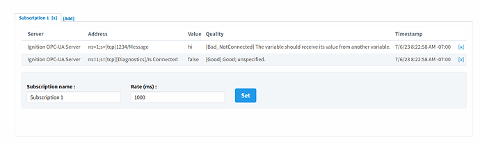

**Post date:** [July 6, 2023, 3:23pm UTC](https://forum.inductiveautomation.com/t/tcp-device-is-connected-diagnostic-tag-issues/75997/7 "2023-07-06T15:23:42Z")
FWIW, the "Is Connected" tag works fine for me with a quick test in 7.9.21.
 ![image](https://us1.discourse-cdn.com/inductiveautomation/original/3X/a/5/a504ffe518aa1d1db18f851b7aeab54889a81419.png)
