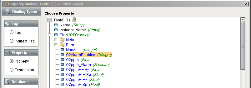

Hi all, I am a new Ignition user and I am working on an existing project (not developed by me). At the moment I am trying to add some functionality on an existing template but without success, maybe you can help me… this is the situation:
- The project has a Tag datatype defined for a process tank, lets call it _Tank_
- Also we have a template which one uses this datatype as property, lets call it _TankS_
With the new functionality I am trying to do the next:
1. Add a new memory tag to the Tank datatype, lets call it _AlarmEnabled_
2. Edit the template adding a 2 state toogle button which will switch on/off the AlarmEnabled memory tag on its Tank

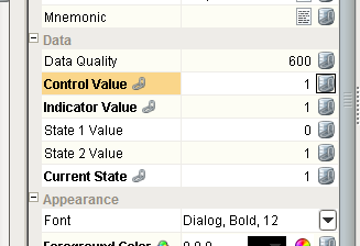

I got success with the item 1 and also I did edit the template and I did add the 2 state toogle button binding its Control, Indicator and Current State properties to the AlarmEnabled tag
![Binding%20Lock%201](https://us1.discourse-cdn.com/inductiveautomation/original/2X/d/dd028fb6d9351c6f4570330a37bb8e4d5e5732f5.png)
But when I run the project, the toogle button switch on/off but the AlarmEnabled tag do not change (seems like the event hasn’t effect over the memory tag).
About this, when the binding panel opens I can see a small padlock near to the Tank node on the tree (please look at attached picture)
 ![Binding%20Lock](https://us1.discourse-cdn.com/inductiveautomation/original/2X/a/a649a672c1984f3078a3caf86ced1f881c20bfda.png)
I know you can add security to the every element and maybe this is the problem, but I can’t find the rule or the element who has it.
I hope you can help me with this, I will be really gratefull.
Regards

BTW… If I do modify the AlarmEnabled tag value (forcing it) the 2 state toogle button change its state, so the binding works in this way but not from the button to the tag.
