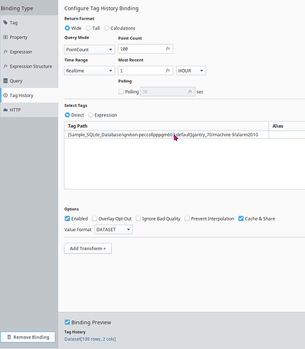

Hello,
I created a Perspective Table with a Tag History “[Sample\_SQLite\_Database/ignition-peccollpppgm603:default]gantry\_10/machine 1/alarm2010“ **and this is working well.**
I am trying to do a template of this table for visualize de alarms of different machines. I tried to configurate a “Custom Tag“ but it is not working. Is there a way to do it?
Thank you for your help
 ![image](https://us1.discourse-cdn.com/inductiveautomation/original/3X/0/a/0ad02dc1d3463d28b358fe243d648239330533df.png)
 ![image](https://us1.discourse-cdn.com/inductiveautomation/original/3X/5/5/556810d5b6db85d1f2e804ea1c166f071d192542.png)

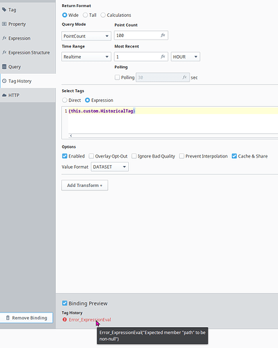

Can you try using Expression in the TagPaths instead of Direct?
It has to be String TagPath. So there you can also access views.params. You can concatenate your basePath + tagName here

Yes, I tried. First 2 images are Expression and the configuration “String Tag path“, and in the 3rd image you can see the direct address working well. I don’t know what I am doing wrong.

It is working now. Sorry I didn’t know about this structure is needed
 ![image](https://us1.discourse-cdn.com/inductiveautomation/original/3X/7/9/799d35e47a50edd02ab1317eb6873aef4061dddb.png)
Thank you
