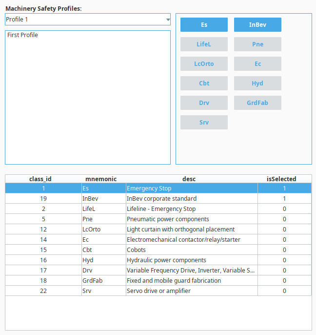

I have an issue with the template repeater and the Toggle Button. The Toggle Button selected value is not being over written when the template parameters dataset changes. In the following cases, I have bound a table component to the templateParams property to easily visualize the data being shown.
First, I select Profile 1 from the drop down. The template repeater shows the expected values.

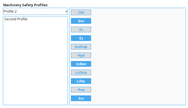

I then select the Profile 2 and the template repeater shows the expected results.
 ![Profile 2](https://us1.discourse-cdn.com/inductiveautomation/original/2X/3/392ecd9e724a29382f696847e9e67fdc55bfb514.png)
Now, showing that the template repeater is working properly with pre-existing data I select Profile 1 again and this time select the Toggle Button displaying SRV.
 ![Select-Srv before choosing other Profile](https://us1.discourse-cdn.com/inductiveautomation/original/2X/f/fbae5e7dd73e85939bfe25ea554f2da5c8e37f01.png)
With SRV now selected, I then choose Profile 2. It is my understanding that the templates Custom Properties should now should be overwritten. But they are not. Please note that the templateParams as shown in the table are correct, but do not correlate.
 ![Select Profile 2 - but template does not overwrite](https://us1.discourse-cdn.com/inductiveautomation/original/2X/d/d5b42902f17d0395d61c074727365244379c7d7e.png)
What is interesting is the fact that the Toggle Button’s displayed name changes, but the index location maintains the “selected” value.

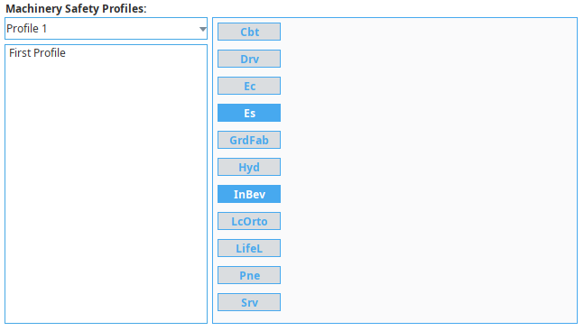

Here is the starting point:
![First](https://us1.discourse-cdn.com/inductiveautomation/original/2X/6/630e335f4f1e1b000ceb7676c862ef45d3ea9313.png)
Then I selected other labels:
![Second](https://us1.discourse-cdn.com/inductiveautomation/original/2X/c/ced9ef9c897dbd5e2a2e7e491f0df294f770cd0c.png)
And then I used the dropdown to select another profile.
![Third](https://us1.discourse-cdn.com/inductiveautomation/original/2X/b/bc241aaeefe284e16d9033b3c99435adacbbe983.png)
The window now functions as it should.

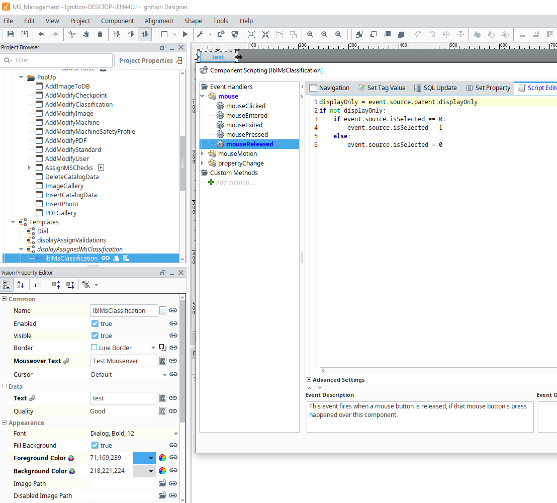

First, I changed from a Toggle Button to label component:
 ![label](https://us1.discourse-cdn.com/inductiveautomation/original/2X/b/b74c66b24207c8527c31970352f4f1bdaf2107ff.png)

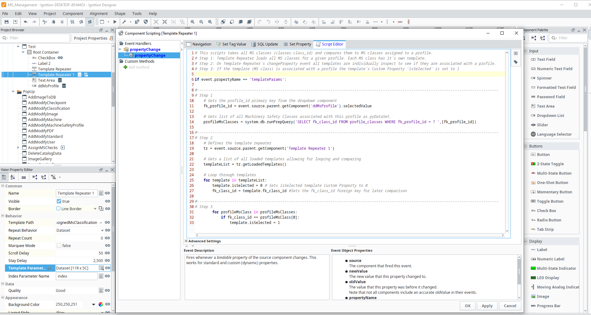

Finally, I wrote a script on the Template Repeater´s propertyChange event to set the Templates ‘isSelected’ Custom Property:
 ![script](https://us1.discourse-cdn.com/inductiveautomation/original/2X/4/4b64f7662911ee5880ec4c1ba4b8c6a73289f324.png)
```auto
# This scripts takes all MS classes (classes.class_id) and compares them to MS classes assigned to a profile.
# Step 1: Template Repeater loads all MS classes for a given profile. Each MS class has it´s own template.
# Step 2: On Template Repeater´s changeProperty event all templates are individually inspect to see if they are associated with a profile.
# Step 3: If the template (MS class) is associated with a profile the template´s Custom Property 'isSelected' is set to 1
if event.propertyName == 'templateParams':
# Step 1
	# Gets the profile_id primary key from the dropdown component
	fk_profile_id = event.source.parent.getComponent('ddMsProfile').selectedValue
	# Gets list of all Machinery Safety Classes associated with this profile as pyDataSet.
	profileMsClasses = system.db.runPrepQuery('SELECT fk_class_id FROM profile_classes WHERE fk_profile_id = ? ',[fk_profile_id])
# Step 2
	# Defines the template repeater
	tr = event.source.parent.getComponent('Template Repeater 1')
	# Gets a list of all loaded templates allowing for looping and comparing
	templateList = tr.getLoadedTemplates()
	# Loop through templates
	for template in templateList:
		template.isSelected = 0 # Sets isSelected template Custom Property to 0
		fk_class_id = template.fk_class_id #Sets the fk_class_id foreign key for later comparison
# Step 3
		for profileMsClass in profileMsClasses:
			if fk_class_id == profileMsClass[0]:
				template.isSelected = 1

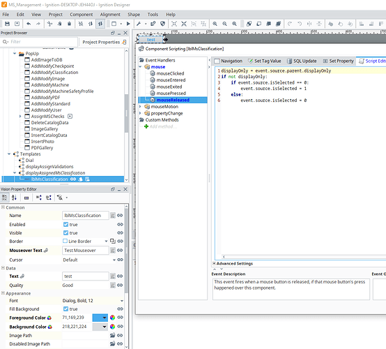

Here is the label component´s mousedRelease button script that provides the same functionality as the Toggle Button:
 ![mouseReleased script](https://us1.discourse-cdn.com/inductiveautomation/original/2X/4/4176de2f4a9df705f52e50b67f3d82d59ed811cd.png)
Thanks again to those who repsonded. If someone sees a more efficient/better method, please let me know.
