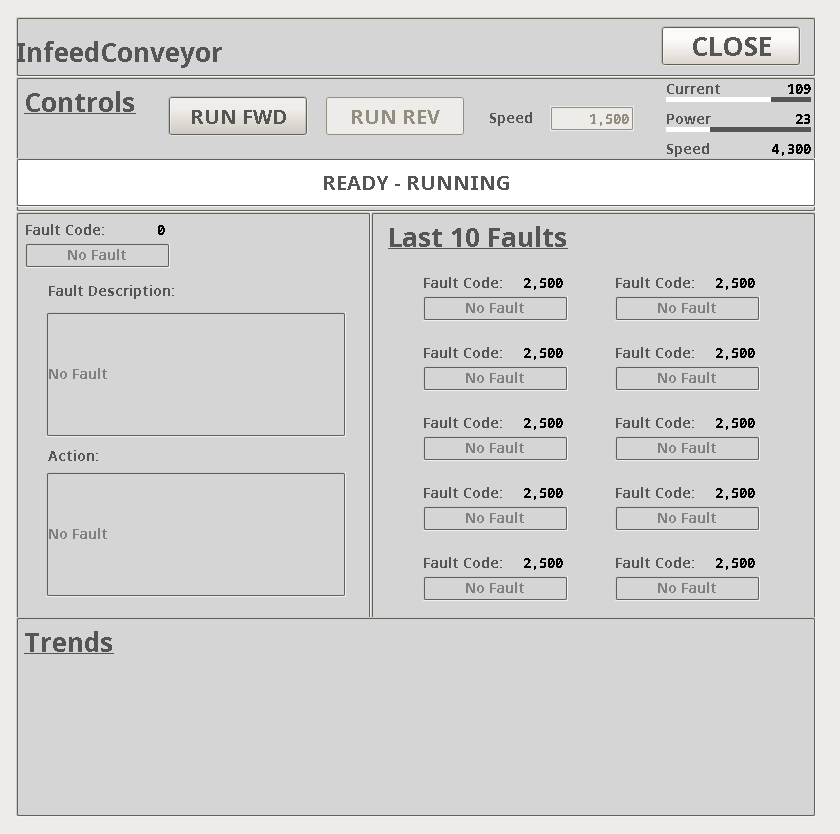

Here is what an instance of the template looks like:
 ![image](https://us1.discourse-cdn.com/inductiveautomation/original/3X/9/1/91184e261ca295017111b5d09d8882edc137ccee.png)

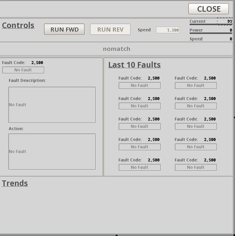

What I want to be able to do is click on template A and have it pull up template B which will use the same UDT.
 ![image](https://us1.discourse-cdn.com/inductiveautomation/original/3X/c/a/cae89768e5c238bbd88992d7fddbd2d555fb9b30.png)
I'm looking for help on the best way to do this. I added a popup page and placed Template B on it... but am unsure on how to make this one instance of the template populate with the correct tags based on which drive (template A) is clicked or if that's even possible. Any suggestions?

And then I have a main drive page... this is how I'm utilizing Template A and each drive uses the template... so there are multiples:
 ![image](https://us1.discourse-cdn.com/inductiveautomation/original/3X/4/6/46b5868e2e67e9ddad6629761d48aad8ab9f5818.png)
I'm looking for a way to have that I can have just one singular popup page that changes based on what drive is selected on the main drive page.
 ![image](https://us1.discourse-cdn.com/inductiveautomation/original/3X/b/1/b15d957702184c533dad498c4f2273560c6bae0d.png)
I'm not sure how I can instantiate template B the same as I did template A without having multiple popups for each drive that use Template B.
