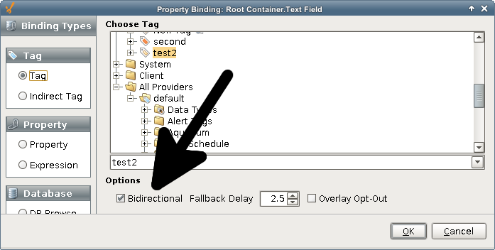

I am working with the text field input for string tags. If I add a text field from the component palette and link a string tag to the Data.Text property it doesn’t work. I can change what is in the text box but it doesn’t update the tag. But if i drag the tag and tell it i want a text field it works just fine.
I have checked the properties of both the text fields to make sure that they are the same and they are as far as i can tell. Even text field that were working before no longer work.
The project i am working in was created in version 7.6 and is now running in version 7.7.0
I have had the same problem with the two stage button. If I link the properties manually it doesn't work but if i drag and drop the tag it works fine.
Please let me know what can be done to make them work correctly.
**Author:** ![nmudge](https://sea1.discourse-cdn.com/inductiveautomation/user_avatar/forum.inductiveautomation.com/nmudge/32/3394_2.png) [@nmudge](https://forum.inductiveautomation.com/u/nmudge)\
**Post date:** [July 21, 2014, 11:06pm UTC](https://forum.inductiveautomation.com/t/text-field-input-problems/8765/2 "2014-07-21T23:06:11Z")
Do the tag bindings to the text fields have “Bidirectional” checked?
 ![](https://us1.discourse-cdn.com/inductiveautomation/original/2X/a/a2150fb9fd0d88a144bf3f7bca3e0823cfe7058b.png)
