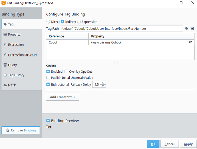

**Author:** ![Ryan\_Craig](https://avatars.discourse-cdn.com/v4/letter/r/45deac/32.png) [@Ryan\_Craig](https://forum.inductiveautomation.com/u/Ryan_Craig)\
**Post date:** [June 9, 2023, 1:47pm UTC](https://forum.inductiveautomation.com/t/text-field-is-clearing-text-after-hitting-enter/74831/3 "2023-06-09T13:47:06Z")
Yes, it seems the binding is Bidirectional
 ![image](https://us1.discourse-cdn.com/inductiveautomation/original/3X/c/0/c0c74017a74cfc1764bad2e0a53128c06e519a14.png)
**Author:** ![djs](https://avatars.discourse-cdn.com/v4/letter/d/e47774/32.png) [@djs](https://forum.inductiveautomation.com/u/djs)\
**Post date:** [June 9, 2023, 1:49pm UTC](https://forum.inductiveautomation.com/t/text-field-is-clearing-text-after-hitting-enter/74831/4 "2023-06-09T13:49:47Z")
Do you see anything in the gateway logs? Perhaps the specific tags or tag provider have readOnly permissions set?
