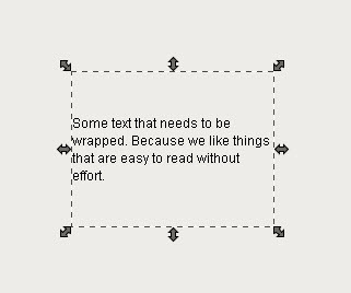

Hi tamer,
For a label, you can word wrap by using an html prefix.
```auto
<html>Some text that needs to be wrapped. Because we like things that are easy to read without effort.

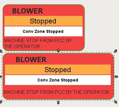

Hi Jordan
Thanks for your support .it’s seam i didn’t clarify my question in proper way .
i have text label binding in sql query . query result is a text which i need to warp .
Select Description from Sideldowntime where code ={PETMachineData.Downtime} and Equipmenet="{PETMachineData.MachineName}"
the result length is not fixed based on description .

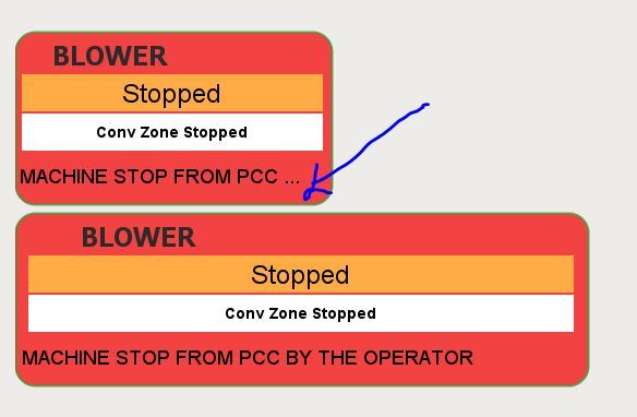

**Post date:** [June 6, 2018, 6:51pm UTC](https://forum.inductiveautomation.com/t/text-field-warp-inside-template/18270/7 "2018-06-06T18:51:31Z")
Use text area instead of a text field. Or move your binding to a custom string property, then use an expression to add `<html>` to the beginning of the description.
**Author:** ![tamerplc](https://avatars.discourse-cdn.com/v4/letter/t/d78d45/32.png) [@tamerplc](https://forum.inductiveautomation.com/u/tamerplc)\
**Post date:** [June 6, 2018, 6:54pm UTC](https://forum.inductiveautomation.com/t/text-field-warp-inside-template/18270/8 "2018-06-06T18:54:42Z")
for more clarification
 ![](https://us1.discourse-cdn.com/inductiveautomation/original/2X/a/a0e30ae5ec0858a0c1323d2441f3d606412dfc9e.JPG)
**Post date:** [June 6, 2018, 7:06pm UTC](https://forum.inductiveautomation.com/t/text-field-warp-inside-template/18270/9 "2018-06-06T19:06:09Z")
Either limit the description length in the database to match your available gui space, increase the vertical GUI space to accommodate line-wrapping as described above, or dynamically change the font size based on the number of characters to display.

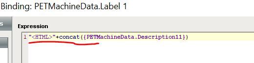

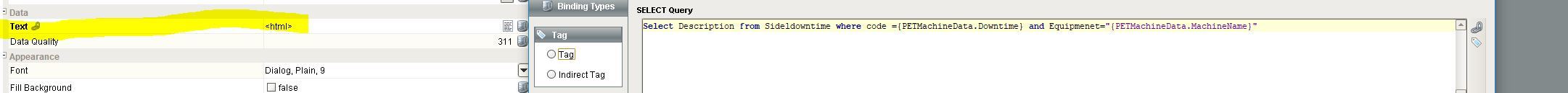

**Post date:** [June 6, 2018, 7:19pm UTC](https://forum.inductiveautomation.com/t/text-field-warp-inside-template/18270/10 "2018-06-06T19:19:59Z")
Thank a lot @pturmel it working as per your recommendation . String Property \>\> Added with expression .
