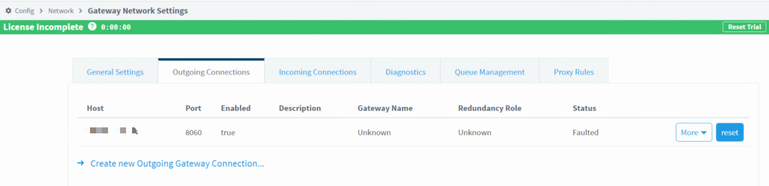

Dear all
I found and approved the following error on the main server after configuring Outgoing Connections. I have no clue why
Everything worked fine before
Can you give me some references? Thank you
 ![image](https://us1.discourse-cdn.com/inductiveautomation/original/3X/0/0/00037023220214934d8fdd61926b445241d88e66.jpeg)
Master server
 ![image](https://us1.discourse-cdn.com/inductiveautomation/original/3X/3/5/35e1941cd8887b36819701a6c645d3964070030e.jpeg)
sub server
 ![image](https://us1.discourse-cdn.com/inductiveautomation/original/3X/7/3/73d8648950ba9eda8f3f76f3df65cd3f462cbe36.jpeg)
**Post date:** [December 9, 2024, 1:20pm UTC](https://forum.inductiveautomation.com/t/the-connection-to-the-gateway-network-fails/99573/2 "2024-12-09T13:20:51Z")
Check in the target server's log for a more detailed message. If there isn't one, or it mentions a broken connection, then you are suffering from a firewall in your network path that doesn't support websockets.
