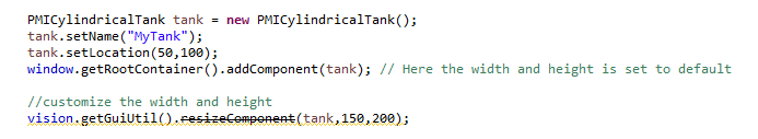

I am using ignition SDK version 7.9.5-snapshot and the mentioned methods are deprecated. Can anyone please suggest an alternative to set width and height of PMI components at run time.
**Post date:** [July 2, 2018, 12:45pm UTC](https://forum.inductiveautomation.com/t/the-methods-resize-component-reshape-component-and-move-component-of-window-utilities-are-deprecated/18687/2 "2018-07-02T12:45:58Z")
Your constructor should set the default height and width for the component directly. That’s what will apply when the user drags the component out of the palette.

Hi Phil,
I am not clear with the constructor you are talking about.
here is my code:
 ![](https://us1.discourse-cdn.com/inductiveautomation/original/2X/f/f0769c306b25b67b02162fa8189942e097aa3bfe.png)
I am looking for an alternative to resizeComponent as it is deprecated.
Please suggest.
Thanks,
Mukta
**Post date:** [July 3, 2018, 12:27pm UTC](https://forum.inductiveautomation.com/t/the-methods-resize-component-reshape-component-and-move-component-of-window-utilities-are-deprecated/18687/4 "2018-07-03T12:27:22Z")
Hmm. You said you were using the SDK, so I assumed you were implementing a new component in a module. In Java. For jython purposes, those methods have all been replaced by [system.gui.transform()](https://docs.inductiveautomation.com/display/DOC79/system.gui.transform).
