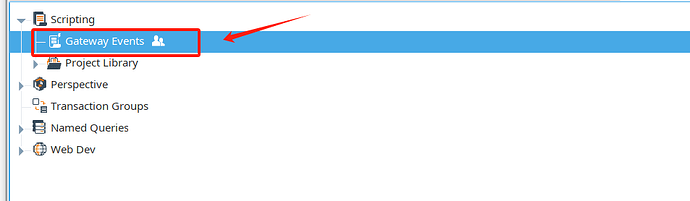

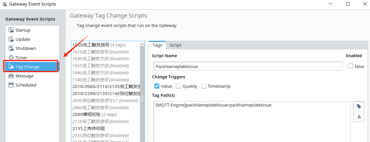

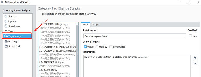

Will the Events in Gateway Events be rerun when the script is updated and saved for a running project?
 ![11](https://us1.discourse-cdn.com/inductiveautomation/original/3X/0/c/0cdacbcb1bc85a11b084ce2ef73536e16ecc4a28.png)
 ![12](https://us1.discourse-cdn.com/inductiveautomation/original/3X/f/9/f906954c9a017afb39d7333f9cc7adebc921713a.png)

I believe so but you can avoid that by filtering the initialChange, just add this before the rest of the script, fixing the identation of course:
```auto
if not initialChange:
