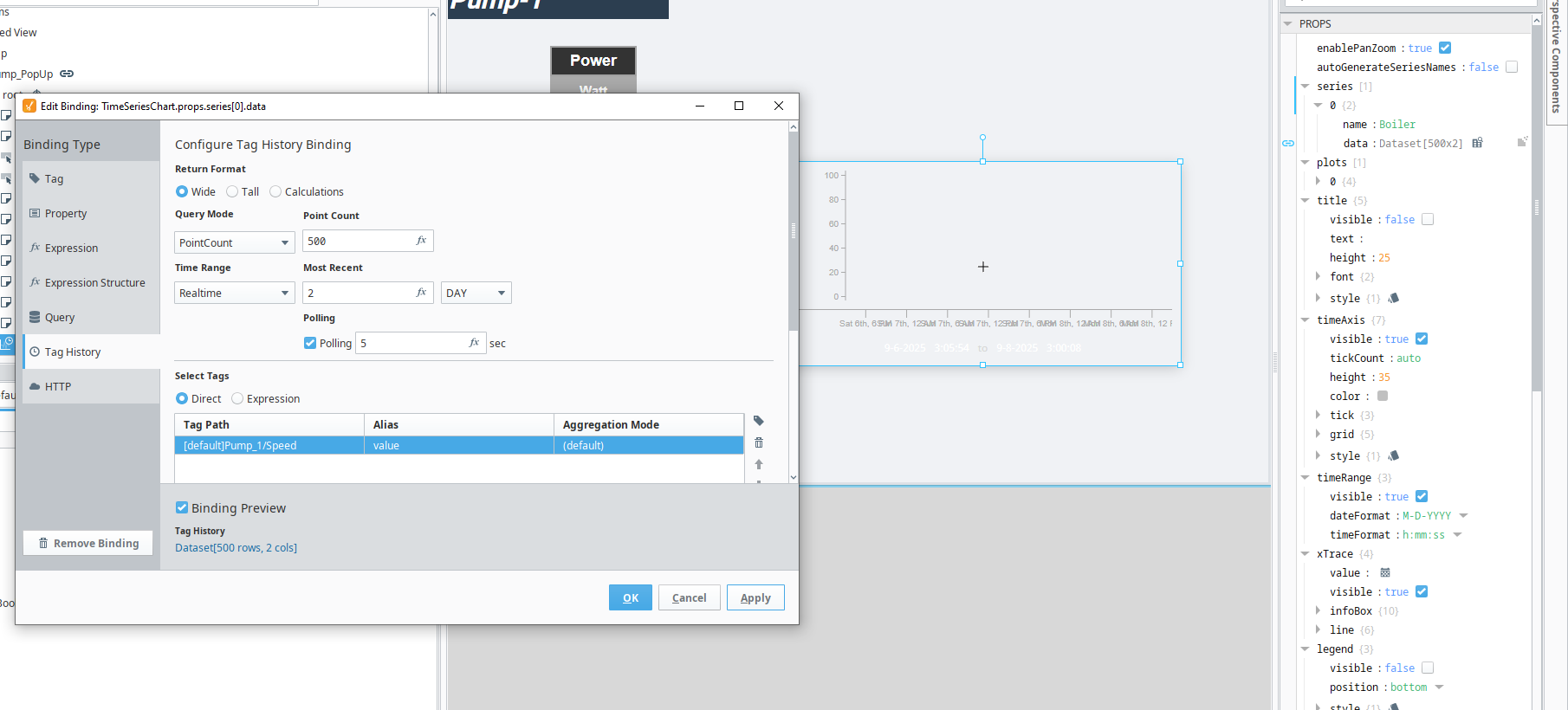

I am trying to populate the data in the Time series chart here, I’ve tried the following:
- Using The Generic Tags Like Sine and realistic, It’s Works Properly✅
but here is my issue, i configured my own tag and made it as historian tag to store the data periodically in MySQL, And it works fine here, So once i go to the chart and populate it with this tag history, it doesn’t work, it shows data that has only date and the other column i of values is empty.
\<\< Note \>\> When i make a name query for this works fine like in the second picture
so could anyone help me, and what’s the better option to populate the chart generally

**Post date:** [September 8, 2025, 11:59am UTC](https://forum.inductiveautomation.com/t/time-series-chart-populating-data-issue/110441/6 "2025-09-08T11:59:23Z")
Considering the `Speed` column of your history result is empty, then it must be your history binding. Tag path typos ad/or incorrect datetime boundaries are most likely. You haven't shown that binding configuration/details.
**Author:** ![ahmedsaeeed907](https://avatars.discourse-cdn.com/v4/letter/a/fbc32d/32.png) [@ahmedsaeeed907](https://forum.inductiveautomation.com/u/ahmedsaeeed907)\
**Post date:** [September 8, 2025, 12:07pm UTC](https://forum.inductiveautomation.com/t/time-series-chart-populating-data-issue/110441/7 "2025-09-08T12:07:02Z")
here it is the binding of the tag history
and the values of that tag in mysql
 ![image](https://us1.discourse-cdn.com/inductiveautomation/original/3X/d/f/df83f64f2c8abdfcbff94b485f70f8a086b32bdb.png)
 ![image](https://us1.discourse-cdn.com/inductiveautomation/original/3X/5/6/56b3178c7b63997aa80b154e9e1b59a967aa7b5a.png)

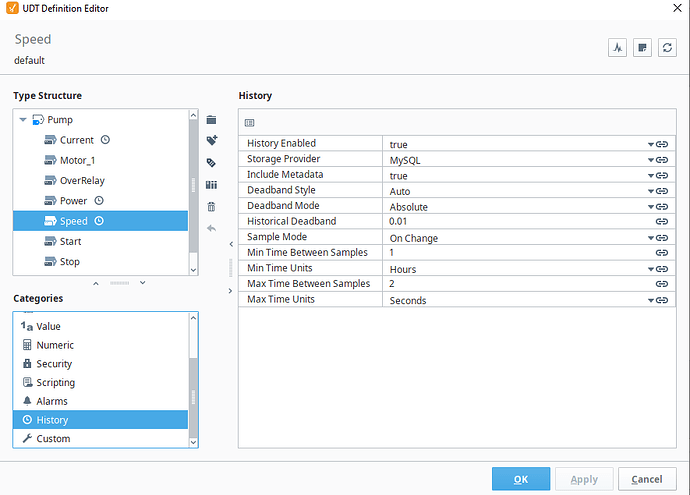

**Post date:** [September 8, 2025, 12:37pm UTC](https://forum.inductiveautomation.com/t/time-series-chart-populating-data-issue/110441/11 "2025-09-08T12:37:25Z")
there’s a point here as well, i make mysql as a history provider, and i assigned some tags to it even though it’s empty when i try to pick up a tag from it
 ![image](https://us1.discourse-cdn.com/inductiveautomation/original/3X/c/e/ce8478f10fb8be2e8522078d730f48635d86e217.png)
