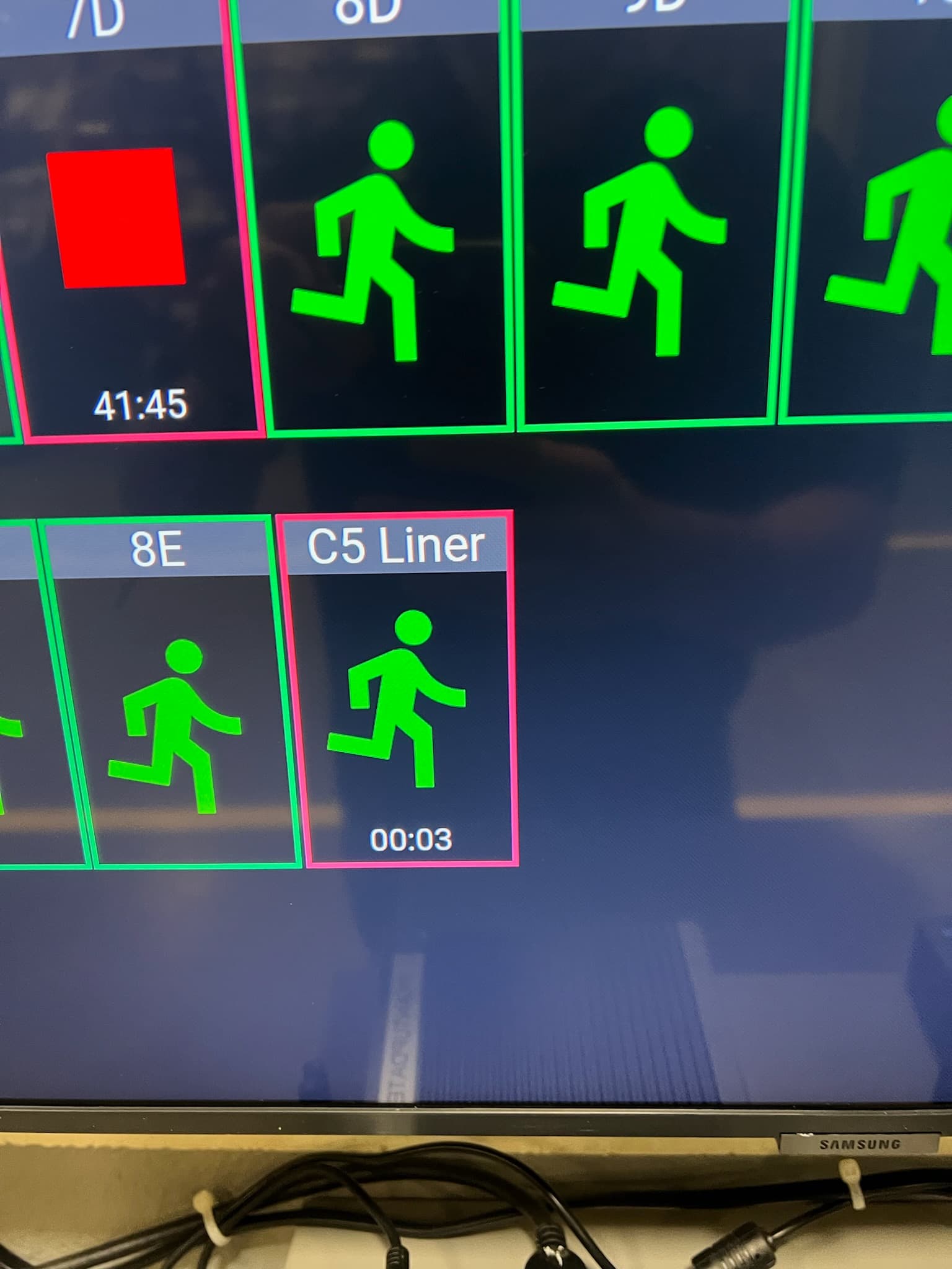

![IMG_8590](https://us1.discourse-cdn.com/inductiveautomation/original/3X/4/e/4effa7fe88c6bfa29689e6b2a7b31e8847eb5f9e.jpeg)
So I have about 8 dashboards around our plant showing running status of machines. I have formatting for the border to be green when “machine status” = 1 and red when =0. Basically the same for the icons, same tag reference. But the icon is not always correct as seen in the image. I can have 2 views right next to each other and 1 will be correct and the other will not.
Im open to other ideas for solution if you have any

So you want two views, which would be identical in appearance, except one would have the right coloring and the other would have the wrong coloring?
I would try instead to just make the one view work.
What is the current issue with the view that makes it not right, what conditions? I am assuming your `machine status` is an opc tag right?

> [@Tyler\_Esters1](#):
Can you show us how you have configured the binding on the border to the the `machine status` tag?
If you've done this properly all views will update simulataneously.
